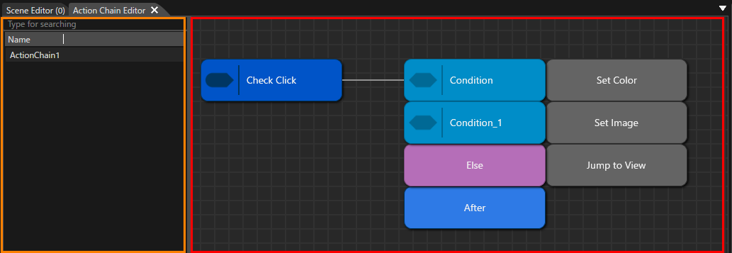

The Action Chain Editor consists primarily of the following two panes.
By default, the Action Chain Editor panel is hidden. To display it, choose View > View Editor > Action Chain Editor from the menu bar.
UI items Description
Left pane (orange frame in the figure above)
Manages multiple Action Chain diagrams in a list. You can organize diagrams by feature or by input device, and perform operations such as creating, opening, renaming, and deleting.
Right pane (red frame in the figure above)
The workspace for editing the selected Action Chain diagram. Place and connect Trigger, Action, and Condition nodes to define the processing flow.

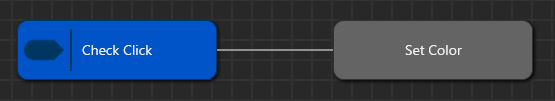

Case 1: Basic single-condition if
The simplest Action Chain: one condition and one action.
  • A trigger (Check Click) detects the event; if the condition evaluates to true, a single action (Set Color) runs.
if (Check Click)
    Set Color();

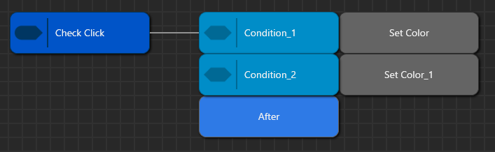

Case 3: Exclusive branching (if / else if)
This configuration shows how to evaluate multiple conditions for the same event exclusively (if / else if) so that only one action runs.
Place two rows—Condition_1 and Condition_2—stacked vertically one column to the right of the Trigger, and place their corresponding Actions (Set Color / Set Color_1) to the right of each row. This represents:
  • Upper row: if (Condition_1) { SetColor(); }
  • Lower row: else if (Condition_2) { SetColor_1(); }
To make the branch’s common exit explicit, place a single After node at the end of the block formed by Condition_1 and Condition_2. The After node denotes “the exit for this if/else if group,” and all subsequent processing should connect to the right of the After node. With this layout, it is visually clear that regardless of which condition is met, the flow ultimately merges into the same continuation.
if (Check Click)
    if (Condition_1)
        Set Color();
        Set Color_1();

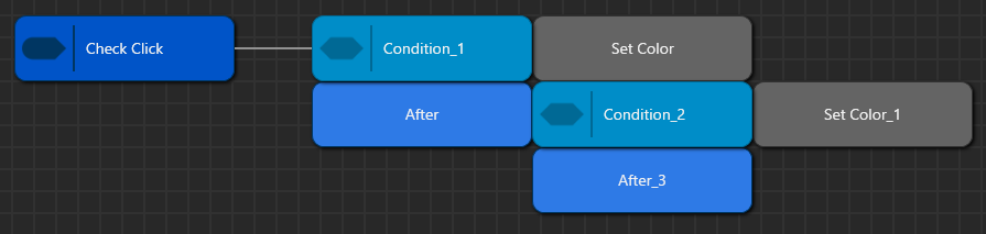

Case 4: Two independent if blocks under the same Trigger
This configuration evaluates two Conditions independently and in sequence within a single Trigger.
  • The After placed beneath the Condition_1 + Set Color row is a mandatory exit: the flow passes through it whether Condition_1 is true or false, and then proceeds to Condition_2.
    • As a result, Condition_2 is always evaluated, regardless of the outcome of Condition_1.
  • The After_3 placed beneath the Condition_2 + Set Color_1 row marks the end of the entire chain.
By contrast with Case 3, where stacking Condition Blocks in the same column and using a single After yields exclusive branching (i.e., the next Condition is checked only if the previous one was false), Case 4 inserts an intermediate After between the rows so that both if blocks are evaluated in order.
if (Check Click)
    if (Condition_1)
        Set Color();
    if (Condition_2)
        Set Color_1();

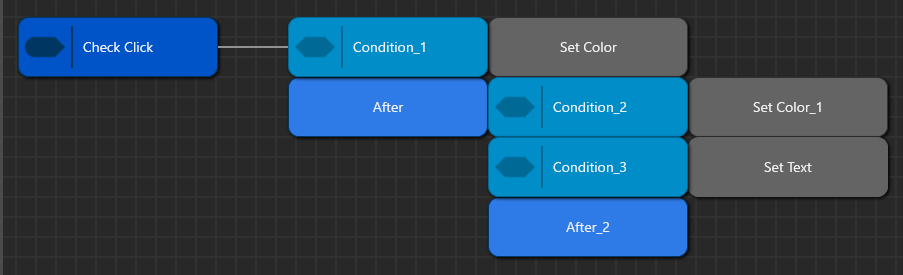

Case 5: Independent if + subsequent if/else if group
This configuration combines a single standalone if followed by an if / else if branching group under the same Trigger.
  • Row 1 (Condition_1 + Set Color) corresponds to:
    • The After directly beneath Row 1 is a mandatory exit. The flow passes through it whether Condition_1 is true or false, and then proceeds to the group formed by Condition_2 and Condition_3.
  • Rows 2 and 3 (Condition_2 + Set Color_1, Condition_3 + Set Text) represent:
    if (Condition_2) { SetColor_1(); } else if (Condition_3) { SetText(); }
    • When Condition_2 is true, only SetColor_1() runs; only when it is false is Condition_3 evaluated.
  • The After_2 beneath these two rows is the common exit for the if / else if group.
Compared with Case 4, where both Condition_1 and Condition_2 were independent if blocks, Case 5 has an independent if for Condition_1, followed by an if / else if group formed by Condition_2 and Condition_3.
if (Check Click)
    if (Condition_1)
        Set Color();
    if (Condition_2)
        Set Color_1();
        Set Text();

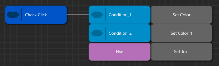

Case 6: Three-way branching (if / else if / else)
This configuration shows a classic exclusive branch with three paths under a single Trigger.
  • Row 1: “Condition_1 + Set Color”
    Corresponds to if (Condition_1) { SetColor(); }.
    Set Color runs only when Condition_1 is true.
  • Row 2: “Condition_2 + Set Color_1”
    Corresponds to else if (Condition_2) { SetColor_1(); }.
    Set Color_1 runs only when Condition_1 is false and Condition_2 is true.
  • Row 3: “Else + Set Text”
    Corresponds to else { SetText(); }.
    Set Text runs only when both Condition_1 and Condition_2 are false.
The key point is that exactly one Action runs: evaluation proceeds top to bottom and executes the Action on the first row whose condition matches.
if (Check Click)
    if (Condition_1)
        Set Color();
        Set Color_1();
    else
        Set Text();

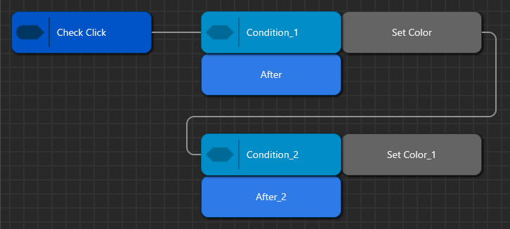

Case 7: Nested if (After-based layout)
This configuration represents a nested if where one Condition Block is evaluated only inside the branch of another.
  • The flow goes from the Trigger Check Click to Condition_1—this is the outer if (CheckClick).
  • The row “Condition_1 + Set Color” corresponds to if (Condition_1) { SetColor(); … }.
  • Because there is a connector from Set Color down to Condition_2, Condition_2 is evaluated only when Condition_1 is true. If Condition_1 is false, the flow does not proceed to Condition_2.
  • The lower row “Condition_2 + Set Color_1” corresponds to if (Condition_2) { SetColor_1(); }. Thus, only when both Condition_1 and Condition_2 are true do SetColor() and then SetColor_1() run in sequence.
  • After and After_2 serve as visual exits/merge points for the Condition_1 block and the Condition_2 block, respectively.
In contrast to Case 4, where two Condition Blocks are treated as two independent ifs that are both evaluated, Case 7 places Condition_2 entirely inside Condition_1, forming a classic nested if structure.
if (Check Click)
    if (Condition_1)
        Set Color();
        if (Condition_2)
            Set Color_1();
