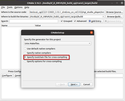

  6. Configure
    • Specify Unix Makefiles as generator for the project.
    • Specify tool-chain file for cross-compiling.
  7. Select the toolchain-file from the delivery (adapt for your toolchain installation and application specific needs)
    /cgi_studio_devices/src/Wayland/ToolchainFiles/GCC-toolchain-Wayland-Linux.txt
    If Vulkan support is required, use the Vulkan-specific toolchain file.
    /cgi_studio_devices/src/Wayland/ToolchainFiles/GCC-toolchain-Wayland-Vulkan-Linux.txt
