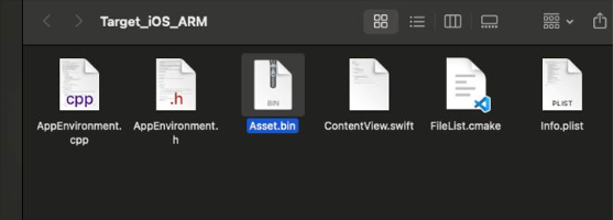

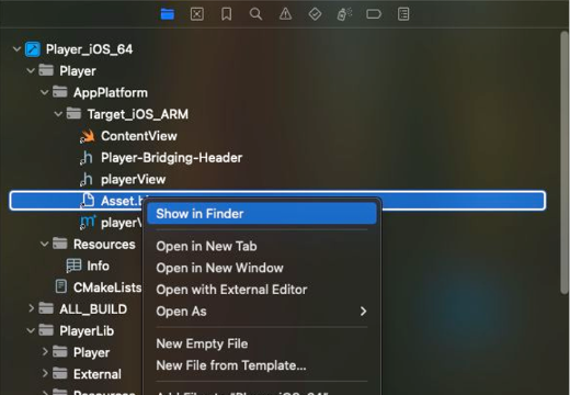

Replacing Asset.bin
To replace the Asset file:
  1. InGo to the Xcodeproject project,root navigate to:
    Player/AppPlatform/Target_iOS_ARM
Locate Asset.bin.
Right-click it and select Show in Finder to open the original file location.
directory.
Replace the existing Asset.bin file with your versionnew of Asset.bin.
version.
