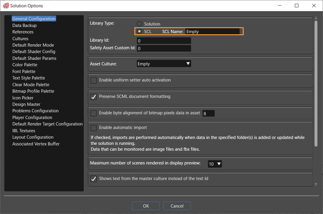

    Library Type:
    Specifies whether the current solution should function as a standard project (Solution) or as a reusable library (SCL: Shared Component Library). When configured as an SCL, the solution can be exported as an archive containing SCML, binary files, and metadata, and then reused in other projects.

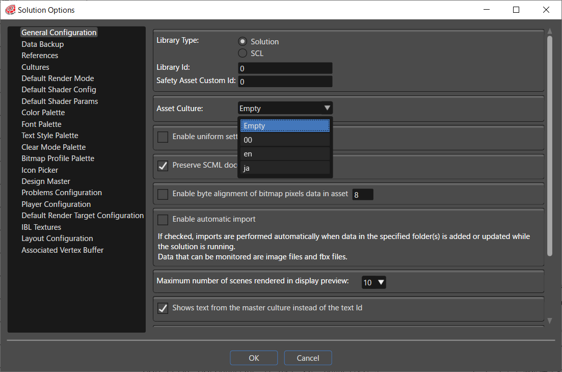

    Asset Culture
    The default culture for the solution can be selected from the [Asset Culture] dropdown menu. This setting affects the entire solution and determines the base language and regional formatting used for localized texts and assets.

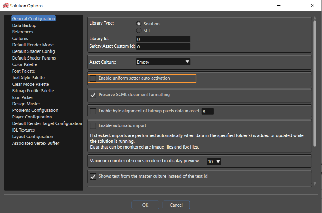

    Enable uniform setter auto activation
    When this option is enabled, ShaderParamSetter configurations are automatically applied. If the "Auto activation scope" property is set to Local, per-asset parameter settings that would normally require manual configuration are handled automatically.
    If the scope is set to Global, the system uses shader-defined Auto Uniforms to determine and apply all relevant activation flags at asset generation time.
    This feature simplifies the configuration process while ensuring consistent rendering behavior. For further information, refer to the Generic ShaderParamSetter documentation.

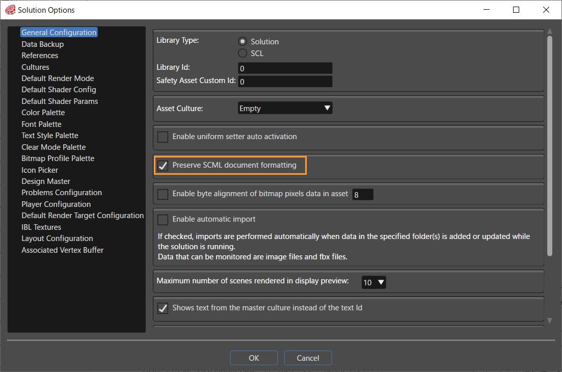

    Preserve SCML document formatting
    Enabling this option allows the SCML Editor to preserve the original formatting and comments in the SCML source files. This is useful for maintaining manually added annotations or structured formatting. For more information, refer to the SCML Editor documentation.

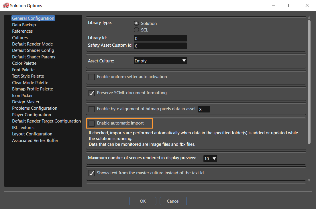

    Enable automatic import
    To automate the import of image and FBX files, enable this option and configure monitored folders. When new files are added or existing ones updated in the specified folders while the solution is running, the import process is triggered automatically.

      Library Setting
      The main goal of a shareable component library (SCL) solution is to make all the resources from a particular SCS solution available to be used in other solutions. An SCL is an archived file containing SCML/binary files and some meta information. SceneComposer provides the possibility to reuse any part from a solution that is exported as an SCL.
      When the user has not decided since the beginning that some parts from the current solution will be reused in a different solution, it is possible to export the solution as a shareable component library (SCL) solution in a different way. For this, the user has to choose the SCL "Library Type" from "File" > "Solution Options" > "General Configuration". The SCL name can be the same with the SCL solution or it can be modified.
      After the solution has been saved, the "Export SCL" option will become available under the "File" menu. In this way, the solution can be exported as a shareable component library (SCL) in any place selected by the user.
      Each library item (library items are items which have a folder as parent) has a LibItemId (32 bit unsigned integer) which uniquely identifies it in the solution. If it is not set (has value 0) an Id will be generated. LibItemId is the Id property displayed in the properties panel for library items ("File" > "Solution Options" > "General Configuration").
      Culture Setting
      The default culture for a solution can be defined in the General Configuration panel by setting it in the "Asset Culture" drop down list.
      This setting will be available for the whole solution.
      Enable Uniform Setter Auto Activation
      There is an option to avoid the detailed (i.e. manual) setting of the uniform setters by using the auto activation property. This is possible if the "Enable auto activation" property is enabled and the "Auto activation scope" property is set local.
      The "Enable uniform setter auto activation" setting is accessible in the "Solution Options" panel, section "General Configuration".
      If this global setting is used and the "Auto activation scope" property is set global, the "Enable auto activation" property will become active and all the activation flags will be determined when the asset is generated based on the auto uniforms which are defined in the shader program.

      Preserve SCML Document Formatting
      When this setting is used, the SCML editor preserves source formatting and comments.

      Enable Automatic Import
      To configure monitored folders for automatic imports - both images and fbx files - it is mandatory to enable this operation by checking the "Enable automatic import" box.
