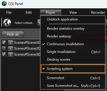

The script system of the Player can be started by typing "start script" into the Player's command window or by enabling Player > Scripting System in the CGI Panel's menu bar.
To stop the script system type "stop script" or by enabling Player > Scripting System in the CGI Panel's menu bar or by disabling Player > Scripting System in the CGI Panel's menu bar.
