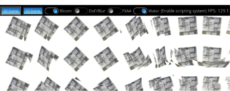

Example of post-processing a 2D scene

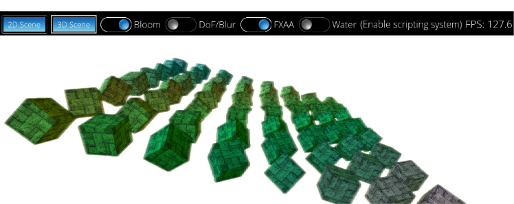

Example of post-processing a 3D scene

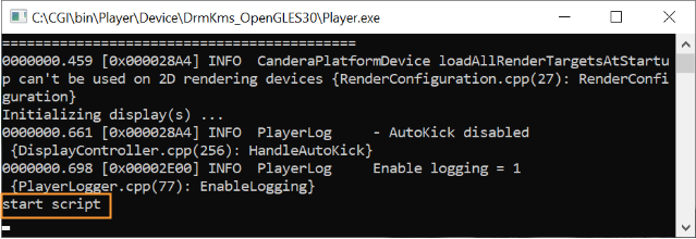

The script system of the Player can be started by typing "start script" into the Player's command window.
To stop the script system type "stop script".
