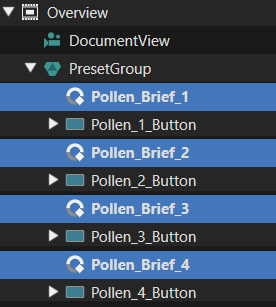

ContaminantList_Popup Scene
This scene contains 4 lists, one list for each of the front page contaminants. We could have had a single list and configure it with the currently selected one upon opening, but this way each will be opened in the same state in which it was closed. String values are sent from the Contaminant template to nodes with databound values, so new contaminants can also be added without the need to modify and recompile the code. Rendering is disabled for these 2 nodes, but could be enabled for debug purposes.
There is a Transparent_EventConsumer node, which covers the area behind the list, and has a “Handle Control State” behavior, to avoid touch events going to elements underneath. Under this, but over all other elements, there is a transparent “TopExit_Button” node, which is used to close the popup when touching outside the list.
