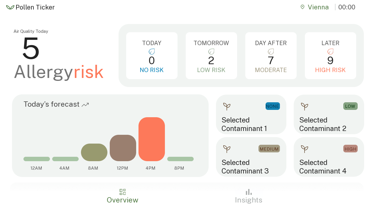

The solution has a resolution of 1280 * 720 and features an overview scene as well as an insights scene where further contaminants are displayed.
Overview scene:
Dynamic Elements:
  • Clock control
  • Air Quality – text value
  • DayRisk control (4 week days)
  • MultihourValue control (bars with 10 levels/images)
  • Pollen_Brief control (level of preselected contaminant, with 4 levels, triggers list of contaminants)
  • City Button (triggers location list)
  • Insights Button (switches to contaminants list scene)

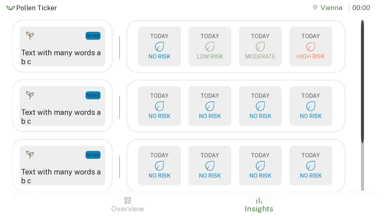

Insights scene:
ContaminantListElement control – List element, composed of other controls:
  • ContaminantName control
  • 4 x ContaminantLevel

Overview Scene
This scene is the most complex of the solution, but it can be managed easily by using several of the templates previously described.
TopLeft: Here we just have a number from 0 to 10, showing the allergy risk for today, and some static text around it. A default “Text Value” control is used, and configured with font style, color, format and data binding.
TopRight: Here we have a list of allergy risk values for today and the next 3 days. Beside the value and day of the week, each also has an icon and fixed text for none, low, moderate, or high risk. For this we use the DayRisk template, and a StackLayout to allign them automatically.
Bottom Left: This displays the allergy risk values during the current day, at 4 hour intervals. The web api provides hourly values, and we display 6 of them, using images associated for value, via the MultihourValue template. The elements are also allligned automatically using a StackLayout.
Bottom Right: Here the user can select a set of 4 contaminants and see the risk level associated with each of them. There are only 4 levels: none, low, mid, high, and no numeric value. We use the PollenBrief template and place them manually. Each element has an associated button, which opens a list from which a user can select a contaminant for the respective slot.
Insights Scene
This scene only contains a list of the contaminants we know of and their level. It is only meant to be viewed, there are no buttons for interaction. The elements of the list are ContaminantListItem templates. The list has a fixed number of 8 elements. The number of received contaminants can be higher or smaller. If Higher, we only show the first 8. If lower, we disable rendering for the unused elements via a “Render Child Nodes” behavior. When there are more elements than visible in the given space, a scroll-bar will appear (and scale move itself appropriately). To customize the “Scrollbar” with imported graphical elements, the Contaminants_List template is used.
