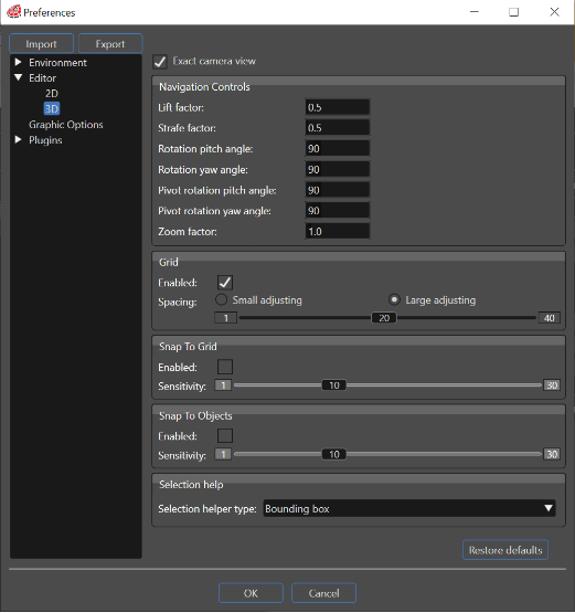

The SceneComposer offers a set of editing helpers that allow editing 3D scenes as simple and intuitive as possible.
All editing aids, which have a visual presentation, are configurable so that the user can disable them easily if not desired. This can be done from the dialog that opens from "File" - "Preferences" menu under the "Editor" node, the "3D" option.
In 3D scenes, SceneComposer offers the following entries in the 3D section of Editor-Preferences:
  • Navigation Controls
  • Grid
  • Snap to Grid
  • Snap to Objects
  • Selection help
Default Camera
For more details about Exact camera view, please refer to Other 3D Editing Aids.
You can also find some 3D Editing Aids in the "View" menu in section "3D Editing Helpers".
Navigation Controls
Lift factor
Lift refers to up and down moving and the lift factor represents a multiplication factor of moving up and down speed. 0 = no action.
The greater the value the faster the camera is moved. Example values: 1, 1.5, 2
Strafe factor
Strafe refers to sidewise moving and strafe factor represents a multiplication factor of sidewise moving speed. 0 = no action.
Rotation Pitch Angle
Rotation refers to rotation the camera around its position and rotation pitch angle represents the pitch rotation angle applied to the camera after 1 second at full rotation speed (mouse outside of the rotation button).
The angle is specified in Degrees.
Rotation Yaw Angle
Angle represents the Yaw rotation angle applied to the camera after 1 second at full rotation speed (mouse outside of the rotation button).
Pivot Rotation Pitch Angle
Pivot rotation refers to orbiting - rotation of the camera around a pivot point (a point in the scene) and pivot rotation pitch angle represents the pitch pivot rotation (orbiting) angle applied to the camera after 1 second at full rotation speed (mouse outside of the rotation button).
Pivot Rotation Yaw Angle
Represents the Yaw pivot rotation (orbiting) angle applied to the camera after 1 second at full rotation speed (mouse outside of the rotation button).
Zoom Factor
Zoom refers to moving camera forward / backward (perspective) or scaling the camera view (orthographic). The Zoom factor represents a multiplication zooming factor. 0 = no action.
The greater the value the faster the camera is zoomed. Example values: 1, 1.5, 2
Snapping
3D Grid
Enable 3D Grid option, when it is checked, enables the grid in a scene 3D. Grid represents a collection of points (1px) laid at a configurable step size.
  • The grid is enabled by checking the checkbox "Enable" from the section Grid, in the "Preferences" - "Editor" - "3D" dialog.
  • The grid is rendered in the background.
Snap to Grid
Snap to grid enables an object to become aligned to the grid when being translated.
  • When snap to grid is enabled, the grid you set works as a magnet; when a selected object is moved, the grid points appear to pull on it when it approaches. This is useful for accurate placement of image elements.
  • Snapping is enabled for all the global bounding box coordinates.
  • To enable this feature check the checkbox "Enable" from the section "Snap to grid" and configure the desired sensitivity (the range is the distance to guideline where the object sticks to the point).
Snap to Objects
Snap to objects enables an object to be aligned to another object's rendering area when being translated. The rendering area is the area that bounds the vertices of the bounding box of the object.
  • An object will be snapped to the closest other object in its proximity.
  • Snapping is available for RenderNodes objects only.
  • A render node is in the proximity of another object (thus will be snapped) if one of the eight points of its bounding box is in the proximity of the rendering area of the other object (rendering area is always a not-rotated rectangle and it bounds the points of the bounding box).
  • The snap feature can be activated/deactivated by checking/unchecking the checkbox "Enable" from the section "Snap to objects" and the proximity range is configurable using the slide control "Sensitivity".

Selection Help
There are three different types available for selection helper.
  • Bounding box: when this option is selected, the user will be able to see the edges of the surrounding invisible bounding box.
  • Region sphere:
    • Camera aligned bounding circle: on this mode the camera will always be oriented toward one bounding circle that will surround the bounding box of the selected object.
    • Static gimbal: a circle for each axis - X, Y, Z will be displayed - not aligned to the camera.
The bounding circle will be visible just if the "Radius" property under the "Bounding Local Shapes" section will be set at a value greater than 0.
  • Both previous types are available. All the modes available for the "Region sphere" type will be available, too.
