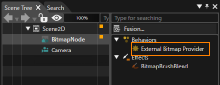

External Bitmap Provider
  1. Drag and drop the [ Node 2D > Bitmap Node ] from the toolbox onto the scene editor, or the scene tree.
  2. Attach [ Behavior > External Resource > Value Processing > External Bitmap Provider ] in the Toolbox to the Behavior in the Extra Scene Tree of the placed bitmap node by drag-and-drop operation.
  3. Click External Bitmap Provider behavior and and specify the target image file to ExternalResourceId in the properties panel that appears. ExternalResourceId can be set in the following two ways.
      • Enter the resource ID directly into the ExternalResourceId text box.
      • Press the select item button on the right side of ExternalResourceId, select the target file from the displayed dialog box, and press the [ OK ] button.
  4. The selected external resource will appear in the scene editor.
    • Save the solution and launch Player to confirm that this external resource is displayed.
