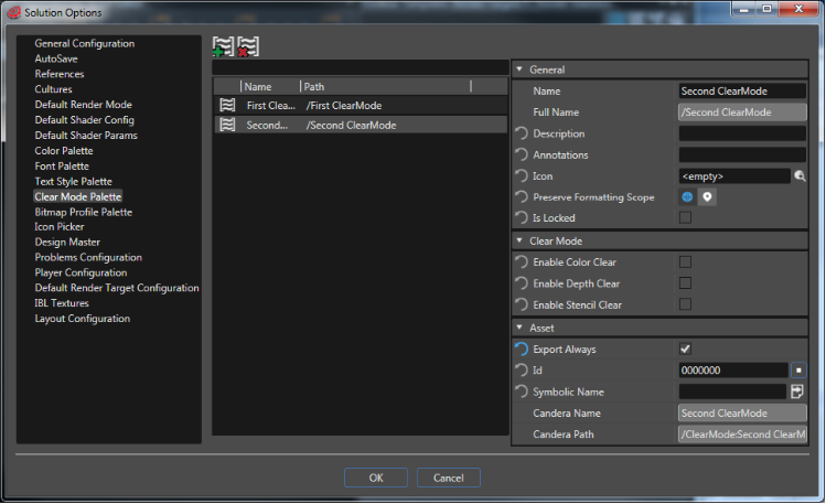

Clear Mode Palette
A ClearMode Palette View was added in Solution Options. By using it ("File" > "Solution Options"), it is possible to create different clear mode items which can be saved and later reused.

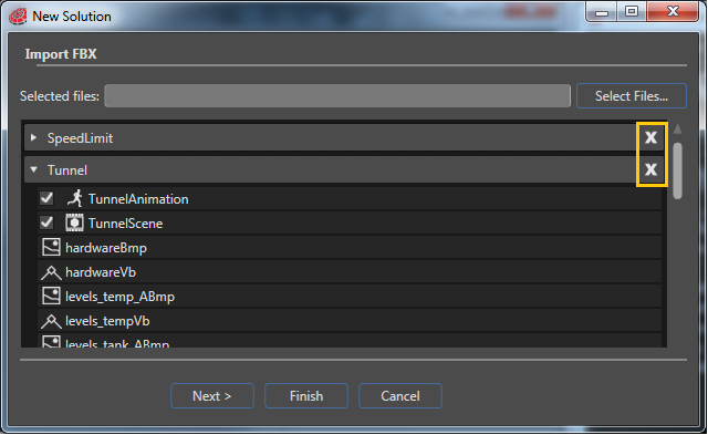

Delete Items
In the ImportView of the "New Solution Wizard", it is now possible to delete selected items before they are imported.

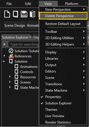

Delete Perspective
The option "Delete Current Perspective" inside "View->New Perspective" is available (at the same level with "New Perspective").

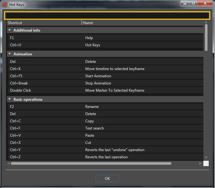

Search Option for Hot-Keys Panel
Due to the huge number of available hot-keys (shortcuts), it could be difficult to find a specific hot-key. In order to solve this issue, a search option was made available in the upper side of the Hot Key panel ("Help" > "Hot Keys").

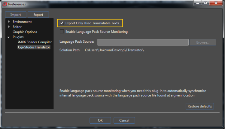

Export Only Used Translatable Texts
In the previous versions of SC, the unreferenced text ids were not exported into the asset. To allow the export of all the text ids even if they are not used, a special option was added. Entitled "Export Only Used Translatable Texts" this option is available as a check box in the "File" > "Preferences" > "Plugins" > "Cgi-Studio Translator" panel.
If the option is used there will be exported just the referenced text ids. If the option is left as default, all the text ids will be exported into the asset.
The plugin does not work in order to receive the notifications if the "Enable Plugin Notification" is not used when the asset is generated.

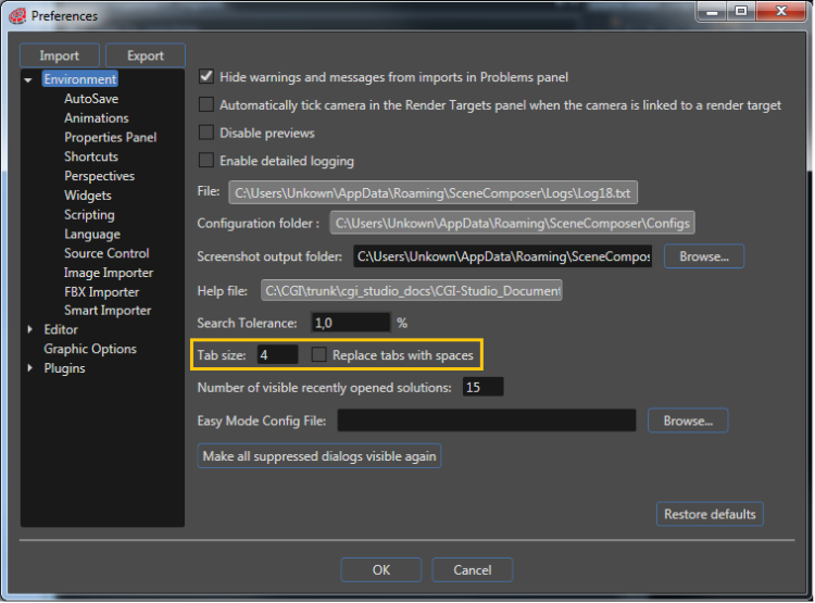

Tab Size Configuration
Tab size configuration was added for the Shader Editor panel ("View" > "Editors" > "Shader Editor"). The user can change the tab size and decide if tabs should be changed to spaces from "File" > "Preferences" > "Environment". (Mantis issue 3724)
