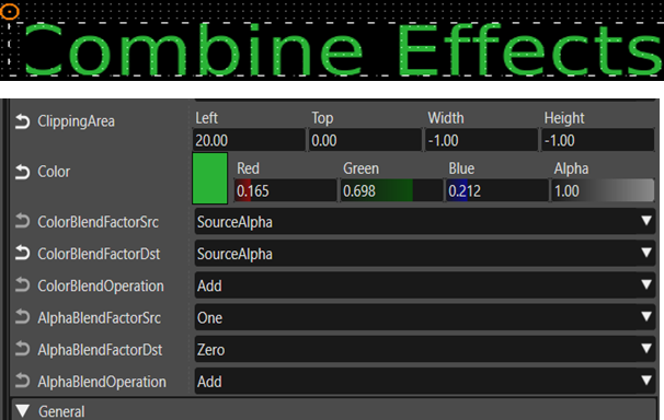

Text with Bitmap Effects
In order to render text, a Text Node with one the following effect must be set in a 2D Scene.
  • Candera::BitmapBrushBlend
  • Candera::BitmapBrushColor
  • Candera::BitmapBrushColorBlend
  • Candera ::GlLinearGradientBitmapBrushBlend
Text node is a Render node that render text using the attached Bitmap Brush effect.
  • Text and Style properties can be set using the Text node properties, as they are inherited from the Render node. To apply Style properties, the font of the text must be set.
  • For  Candera::BitmapBrushColorBlend, the properties Text Color, Color Blend Factors and Operations, Alpha Blend Factors and Operations, and the Text Clipping Area can be set to achieve different rendering effects.
  • An example of  Candera::BitmapBrushColorBlend and related properties is shown below.
