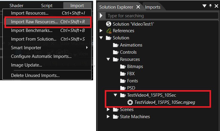

  1. Import the video as raw resource: Using the import menu select “Import Raw Resources”. This ensures that the video is available in its original format for further processing.

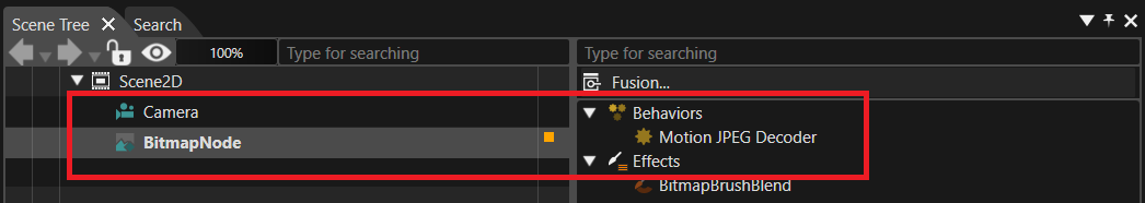

  2. Add the Bitmap node to the scene: Add a bitmap node to a 2D scene.

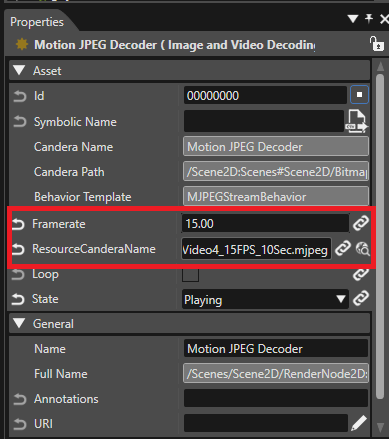

  3. Add the Behavior to a Bitmap Node: Place the Motion - JPEG Decoder behavior onto a Bitmap Node in the scene. Behaviour.pngimage.png
  4. Set the Resource Candera Name: Paste the Candera Name of the raw MJPEG video into the Resource Candera Name property using the steps below.
    a. Step 1: Copy the Candera Name of the raw MJPEG video from the Solution Explorer under the Asset properties of the JPEG resource.
    b. Step 2: Paste the Candera Name into the ResourceCanderaName property of the Motion - JPEG Decoder Behavior in the Properties panel.
  5. Playing in Loop: The video can be configured to play continuously in a loop, if required.
  6. Initial State: The initial playback state of the video can be selected from the dropdown menu, as shown below.
  7. Frame Rate: Ensure that the frame rate is set to match the actual frame rate of the imported M-JPEG video.
