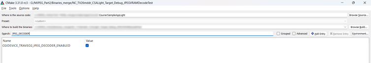

Enabling the JPEG Decoder feature
If the JPEG Bitmap Converter feature is being used, ensure that the JPEG Decoder feature has been enabled in the CMAKE options. While generating the project for target, turn on the CMAKE flag CGIDEVICE_TRAVEO2_JPEG_DECODER_ENABLED or add this flag to the toolchain file.

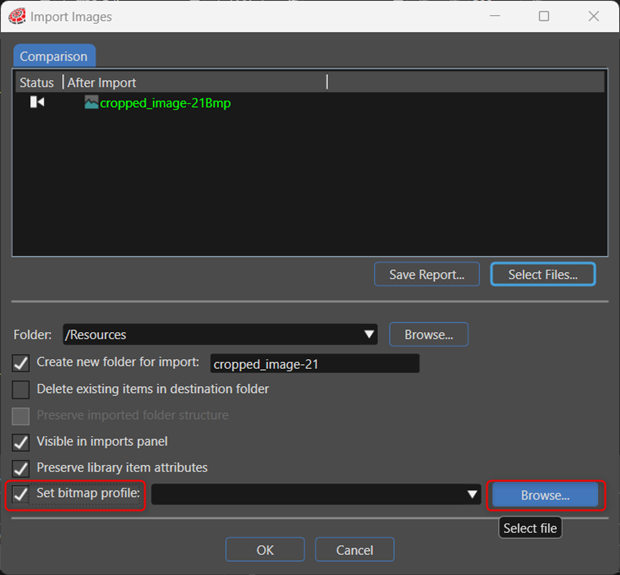

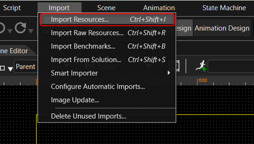

  1. Import the JPEG image: Using the import menu, select "Import Resources"

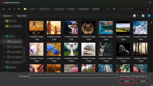

  2. Choose a JPEG image and click "Open".
  3. In the import dialog box, create a new JPEG bitmap profile by checking the “Set bitmap profile” checkbox and then click the “Browse” button as shown in the image below. This only needs to be done once for a new solution, if a JPEG bitmap profile already exists, skip to Step 7.

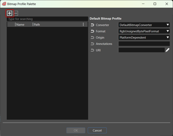

  4. In the Bitmap Profile Palette window that opens, click on the add button as shown in the image below. If the Default Bitmap Profile is not populated on the right-hand side, populate it as shown below.

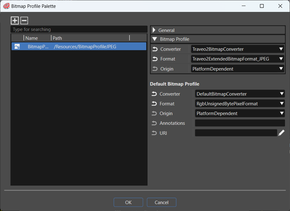

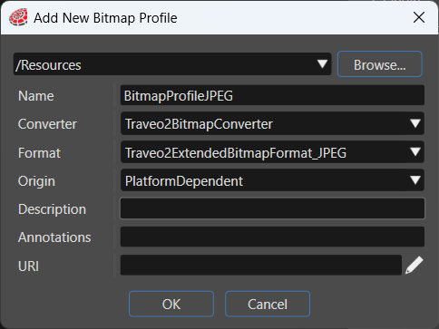

  5. In the Add new Bitmap Profile dialog that opens, populate the fields as shown in the image below. Click “Ok” once done.
  6. On the Bitmap Profile Palette, confirm that the JPEG Bitmap Converter has been added as shown in the image below and press Ok.

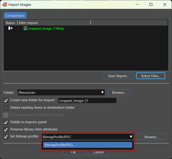

  7. Select the JPEG Bitmap Profile from the dropdown menu if it is not already selected as shown in the image below. Click Ok.

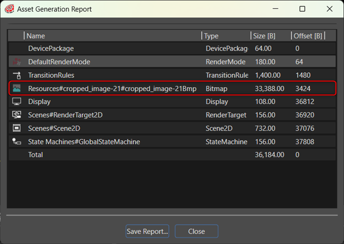

  9. Select “Generate Asset Library” option in File menu to generate the asset and check if the compressed JPEG images have been put into the asset.
  10. The asset generation export report should show the image of the encoded JPEG image. In the image below it is visible that the image is only 33kb which is much lesser than the decompressed bitmap size for the same image.
