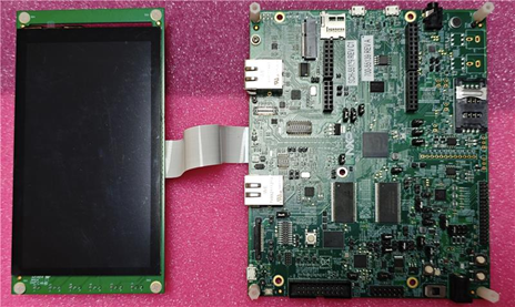

  • NXP RT117X hardware board with display

  • Hardware Variants
    Hardware Revision Supported Display Supported BSP versions Notes
    Rev_a  720 × 1280 only Up to BSP 2.16 BSP versions higher than 2.16 are not supported
    Rev_b 720 × 1280 or 800 × 480 (Raspberry Pi Display) 2.16 and newer
    (e.g., 25_06_00)
    Supports newer BSP versions

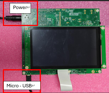

Hardware Connection Setup

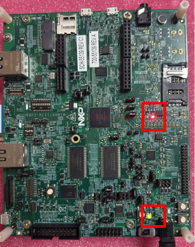

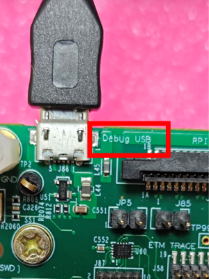

  1. Connect the power cable to the NXP RT117X board.
  2. Connect the Micro-USB port on the board to a USB-A port on your laptop or PC.
  3. Make sure the Micro-USB is connected to the USB Debug port.
  4. Power on the board.
  5. Check if the power LEDs on the board are glowing.

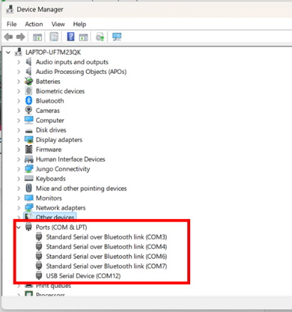

  6. Wait for your system to detect the board. You can verify this by checking Device Manager → Ports (COM & LPT) — a new COM port should appear for the NXP RT117X board.board

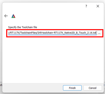

  2. Navigate to the toolchain file as per the hardware revision (rev_a/rev_b) and BSP version used, refer the following table to select the necessary toolchain file:
    Toolchain Table:
    Hardware Revision Toolchain file Description
    Rev_a  IAR-toolchain-RT117X_Native2D.txt Rev_a without Touch
    IAR-toolchain-RT117X_Native2D_Touch.txt Rev_a with touch enabled display
    Rev_b IAR-toolchain-RT117X_Native2D_B.txt Rev_b without Touch support
    IAR-toolchain-RT117X_Native2D_B_Touch.txt Rev_b with Touch enabled display
    IAR-toolchain-RT117X_Native2D_B_Touch_2.16.txt
    and BSP version 2.16

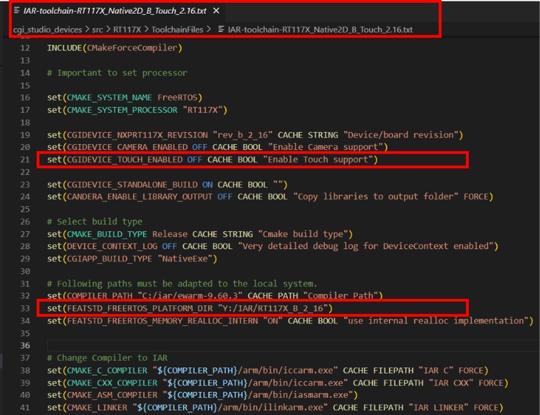

    For Eg: If using a Rev_b hardware version with BSP version 2.16, navigate to the following file.
    (CGI-ROOT/cgi_studio_devices/src/RT117X/ToolchainFiles/IAR-toolchain-RT117X_Native2D_B_Touch_2.16.txt)
  3. Open the file and make the following edits:
    1. Disable touch (only if the display does not support touch)
      set (CGIDEVICE_TOUCH_ENABLED OFF CACHE BOOL "Enable Touch support").
    2. Update the BSP path to match the local directory.

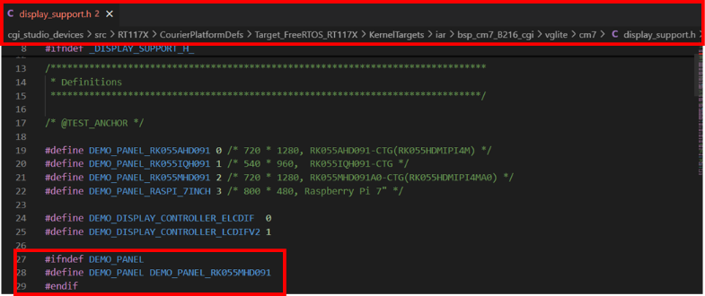

  4. Next, open the following file and update the display configurations as required:
    (CGI-ROOT/cgi_studio_devices/src/RT117X/CourierPlatformDefs/Target_FreeRTOS_RT117X
    /KernelTargets/iar/bsp_cm7_B216_cgi/vglite/cm7/display_support.h)
  5. In this file, go to line 28 and update the display panel configuration as shown below:
    1. Before:
      #define DEMO_PANEL DEMO_PANEL_RASPI_7INCH //DEMO_PANEL_RK055MHD091
    2. After:
      #define DEMO_PANEL DEMO_PANEL_RK055MHD091
      This removes the commented-out section and sets the display to RK055MHD091.

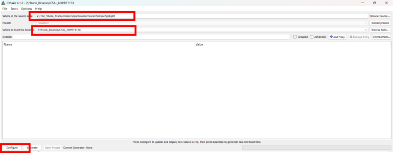

Project Configuration using Cmake GUI
  1. Open CMake GUI.
  2. Set the source code folder to:
     (CGI-ROOT\cmake\Apps\Courier\CourierSampleAppLight)
  3. Set the build folder (the location where build files will be generated).

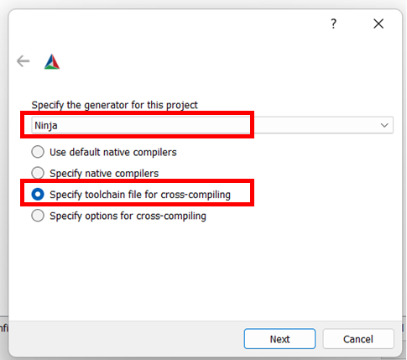

  4. Click Configure.
  5. When prompted, select Ninja as the generator.
  6. Specify the toolchain file for cross-compiling refer the toolchain table, select the appropriate toolchain file as per the hardware version:
    version.
  7. Click Finish → Next.
  8. Click Configure again until all red entries disappear, then click Generate.
  9. Close CMake GUI.

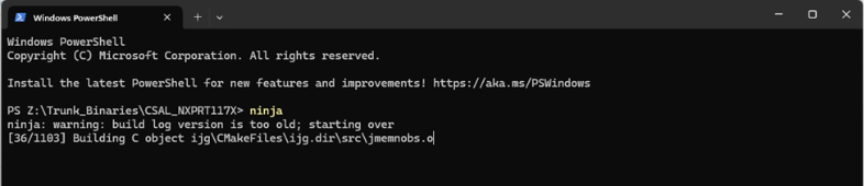

  10. Open terminal in the build folder and give a ninja build.
  11. Run the following command
    ninja

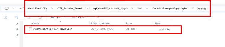

Adding Assets
  1. Create an Assets folder in:
     CGI-ROOT\cgi_studio_courier_apps\src\CourierSampleAppLight
  2. Add the generated asset file to this folder.
  3. Rename it to:
     AssetLibCff_RT117X_Target.bin

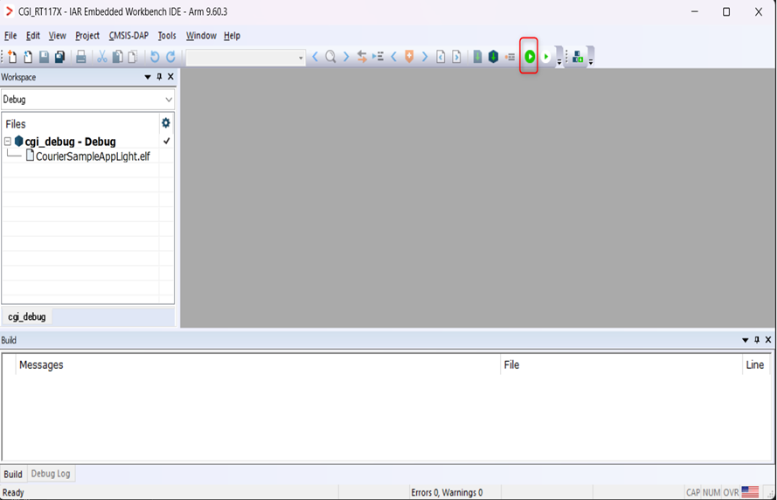

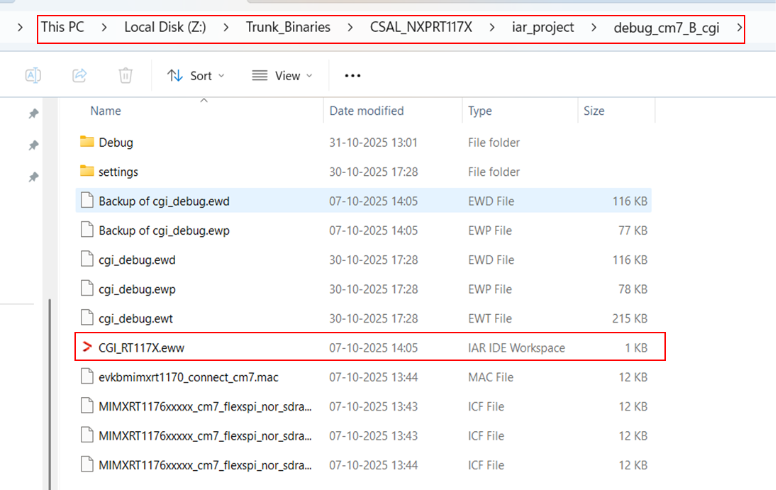

  1. Open the generated project from the following path:
    BUILD-ROOT\iar_project\debug_cm7_B_cgi\CGI_RT117X.ew
  2. IAR Embedded Workbench IDE will launch automatically.
  3. Click Download and Debug to flash the binary to the hardware.
  4. After flashing, click GO in IAR to start execution.

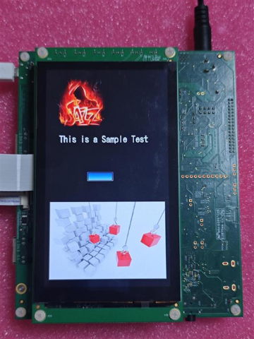

  5. Observe the output on the display connected to the NXP RT117X board.
Verification
  1. Confirm that the display output matches the expected layout from Scene Composer.
  2. Check that images, colors, and animations render correctly.
