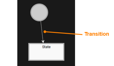

Transition
A Transition represents a connection between two States and are executed when specific conditions are met. Transitions aggregate the sending object, condition, and action. If the condition evaluates to true, the action is executed. Transitions are evaluated based on the logical order defined.
In addition, if multiple transitions are connected to the same state, you can set the priority of the transitions. For details, see here.

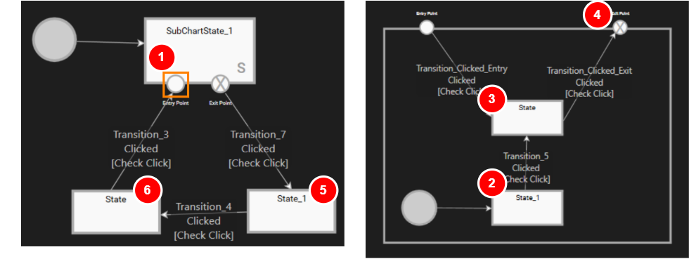

Entry/Exit Point
A Entry Point and a Exit Point are pseudo-states that enable controlled entry and exit to and from a Subchart. They function as clear starting and ending points for entering a Subchart. By setting multiple Entry Points, you can start a Subchart from different points depending on the conditions. Similarly, by setting multiple Exit Points, you can provide different exits depending on the conditions.
Example of Subchart Configuration Using Entry/Exit Point
The following is a simple example of a configuration using a Subchart and Entry/Exit Points.
In the figure above, the Subchart "SubChartState_1" is placed on the diagram.
  • The state machine starts the transition from the Initial State on the diagram, and then moves to Subchart "SubChartState_1" and transitions to the Initial State in the Subchart (see diagram 1 above).
  • A mouse click causes a transition to State_1 of the Subchart (2 in the above figure). Subsequently, mouse click operation causes a sequential transition to State and Exit Point of Subchart (3 and 4 in the above figure).
  • As a result, the state machine transitions from Subchart to State_1 of the diagram (5 in the previous figure).
  • Subsequent mouse clicks will transition to the diagram State (previous figure 6).
  • A mouse click on this State triggers Transition_3, which is connected to the State, and thus re-enters the Subchart via the Entry Point (orange frame area in the above left diagram) again and returns to the State in the Subchart (above diagram 2).
