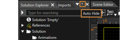

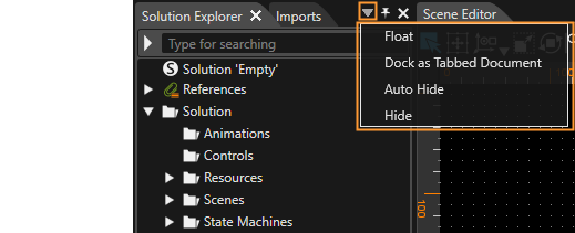

Starting the SceneComposer for the first time, all the panels are provided by default. Some of them are active (i.e. visible) while others are inactive (i.e. invisible). Auto-hide is offered in selected panels, similar to VisualStudio. Click on the pin icon in the top right corner of the panel to activate Auto-hide. Also available are the following options when clicking on the triangle icon on the left of the pin:
  • Float
  • Dock as Tabbed Document
  • Hide
  • Close

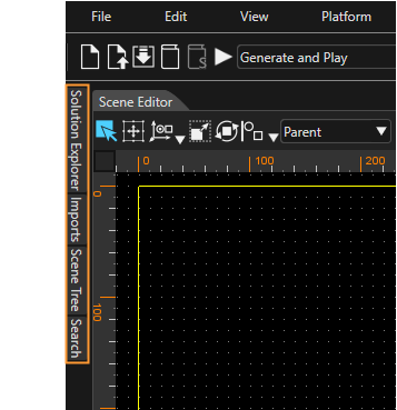

All the hidden panels will be available on the workspace sides of SceneComposer. They can be made visible/active instantly as soon as you hover the mouse pointer over them.

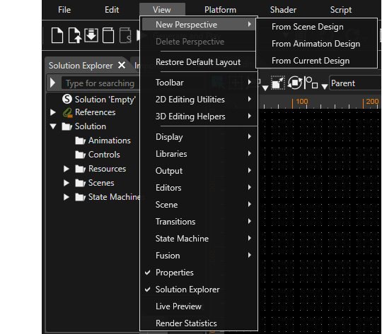

A perspective layout can be saved via "View" > "New Perspective" menu. Three different options are available:
  • "From Scene Design": Creates a new the perspective layout based on the Scene Design perspective.
  • "From Animation Design": Creates a new perspective layout based on the Animation Design perspective.
  • "From Current Design": Creates a new perspective layout based on the current configuration of the perspective.

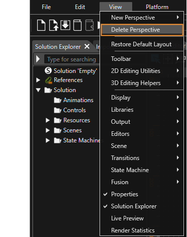

The option "Delete Current Perspective" inside "View->New Perspective" is available when a user defined perspective is selected. Choosing Delete Current Perspective will delete the currently active user defined perspective.
Any saved perspective can be exported in order to use it any time when necessary. Choose "File" > "Preferences" in the menu to open the Preferences dialog. On the left side, under "Environment" select item "Perspectives". Two buttons will be provided: "Import perspectives" and "Export perspectives" to import or export perspective configuration XML files.

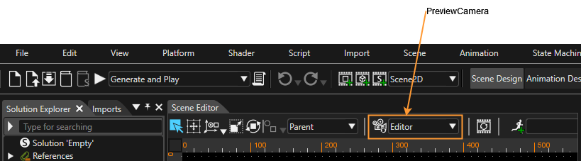

Having selected "Editor" as PreviewCamera, it is possible to
  • move/pan the view by pressing the middle mouse button
  • to zoom in/out with the mouse wheel.
