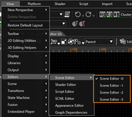

By default, only one Scene Editor is displayed (Scene Editor (0) only). You can display up to four Scene Editors (Scene Editor (0) to (4)) as needed. You can show or hide them from the menu bar [ View > Editors > Scene Editor ].
Displaying multiple Scene Editors is useful when you want to check a 3D model from multiple directions at the same time.
Additionally, scene editors (1) to (3) support floating display. By using floating display, you can display any scene editor on a separate display.
If multiple scene editors are displayed, updates to the solution will be reflected in all displayed scene editors.
