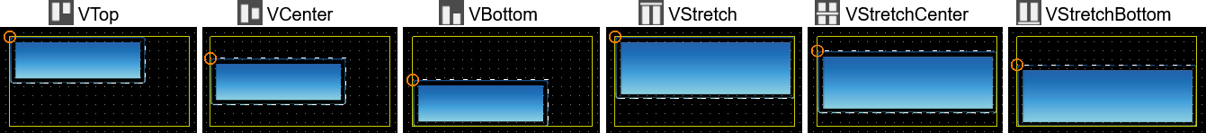

Vertical Alignment: Each layout-able element can specify its vertical alignment inside the area which is available by the parent layout.
The sample images below were created using an OverlayLayout (sized 200x100px) containing an image (sized 151x52px). The image's StretchBehavior property is set to Uniform and its HorizontalAlignment remains at the default value.
To demonstrate the impact of different VerticalAlignment settings, this property has been varied across all options (from VTop to VStretchBottom).

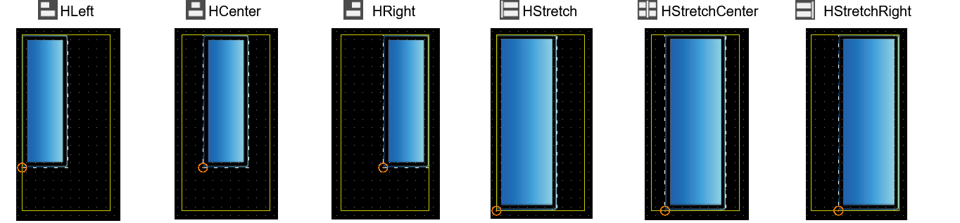

Horizontal Alignment: Each layout-able element can specify its horizontal alignment inside the area which is available by the parent layout.
The sample images below were created using an OverlayLayout (sized 100x200px) containing an image (sized 52x151px). The image's StretchBehavior property is set to Uniform and its VerticalAlignment remains at the default value.
To demonstrate the impact of different HorizontalAlignment settings, this property has been varied across all options (from VLeft to VStretchRight).
