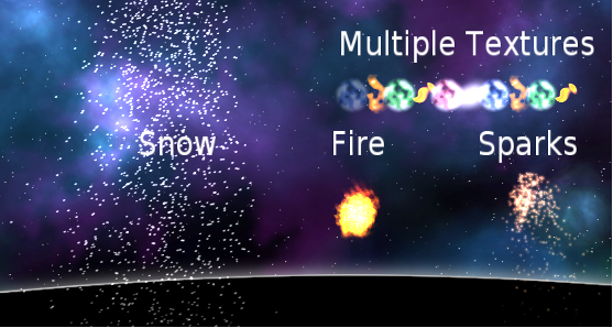

Particles
This use case can be found in the "Scene_Particles" scene. It shows how the Point Sprite Emitter Control can be used to implement different particle effects. The effects shown in this sample are snow, fire, sparks and a sample for multiple textures. Each particle emitter is animated in the appropriate particle animation.
