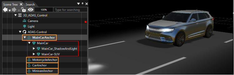

ADAS-Control Anchors:
Users can import their 3D models as FBX or glTF files and attach them to the anchors to replace the default ADAS 3D models. For example, a user can import a new 3D mesh for the main car and make it a child of the MainCarAnchor, as shown in the screenshot below.
ADAS
ADAS-Control 3D models and textures:
Users can use the default vehicle 3D models (FBX files) as a bounding box and import them into DCC tools like 3Ds Max, Cinema 4D, Blender, etc., to create their 3D meshes at the same scale as the default models.
Textures can be exported from the solution explorer window or reimported with the same name and path to replace the existing ADAS control textures.

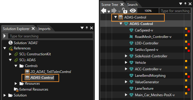

ADAS
ADAS-Control details:
The ADAS control is created using behaviors and effects from the Toolbox window in the Scene Composer. Users can extend or remove parts of this control based on different use cases by double-clicking on the ADAS control in the solution explorer.
Additionally, there is a scene called 3D_ADAS_ExpandControlNode in the scenes folder, which provides an expanded version of the ADAS control.

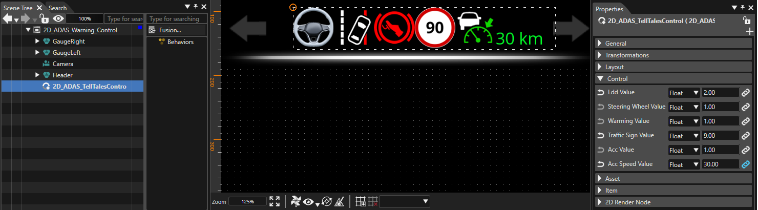

2D_ADAS_TellTalesControl:
This 2D control includes telltales controls and text value. It triggers the rendering of 2D bitmap icons according to the ADAS control conditions, such as altering the Traffic Signs.
This control is optional and can be utilized alongside the 3D ADAS control in a 2D scene.
