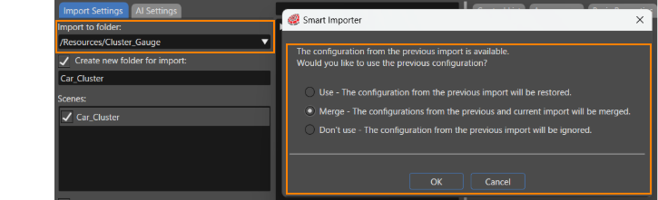

  3. Next, change the import destination to "/Resources/Cluster_Gauge".
    • A dialog box similar to the one below will appear, so select [ Merge ] and then click [ OK ].
    • As a result, the configured Gauge control will be added to the previously configured Telltale control.

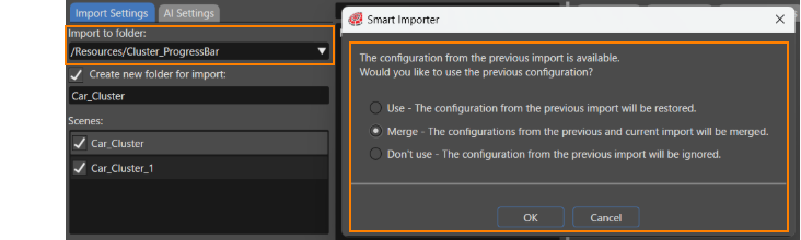

  4. Similarly, change the import destination to "/Resources/Cluster_ProgressBar".
    • As in step 3, a dialog box similar to the one shown below will appear, so select [ Merge ] and then click [ OK ].
    • As a result, the configured ProgressBar control will be added.
