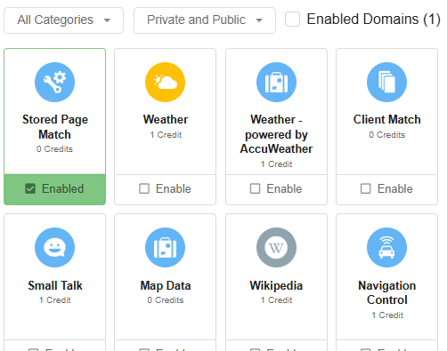

The voice to text/command transcription is realized with Soundhound. To use the Soundhound Api in the blood pressure sample, a free account must be created under https://www.houndify.com/login. Afterwards, a new client must created in the dashboard. In this client, all domains may be deactivated, apart from the "Stored Page Match" domain.
As custom commands on Soundhound are only available in English language, the voice activation feature only support English language.

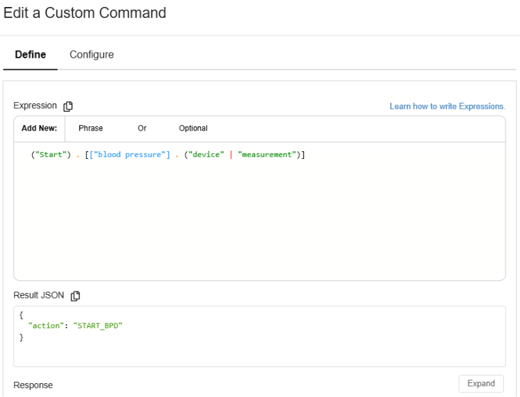

Now, a new custom can be created by navigating to the section "Custom Commands" in the menu on the left side. Enable the custom commands and click "New Page". After entering an arbitrary name for the command like "BloodPressureDevice", a modal window for configuring the command, opens. In der "Expression" input field enter the string
("Start") . [["blood pressure"] . ("device" | "measurement")]
and in the "Result JSON" input field the JSON
  "action": "START_BPD"
like in the image below

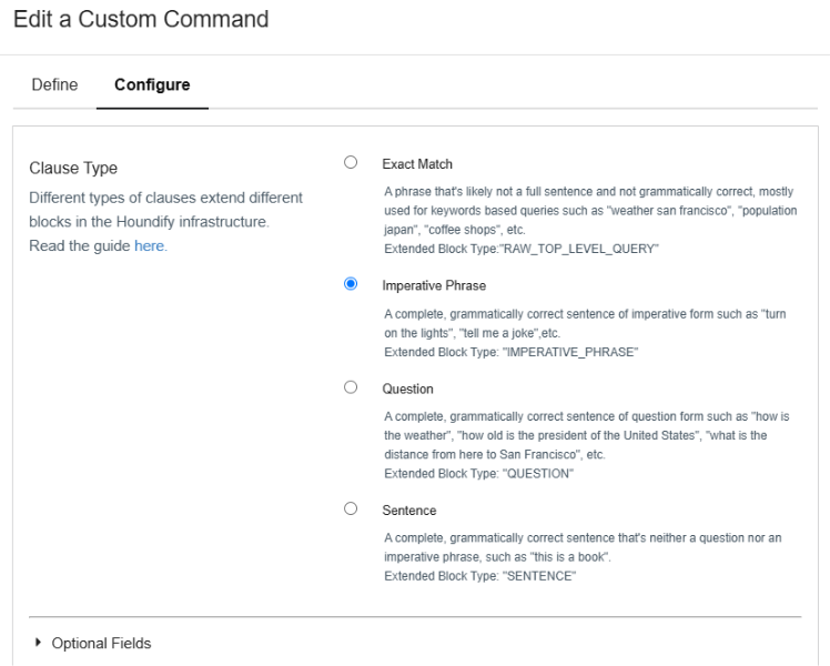

In the header/tab "Configure", select the "Imperative Phrase" radio button

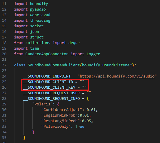

The Soundhound service is now configured and the client credentials must be copied to the Python source files. Navigate to "Overview & API Key" and copy the credentials to the corresponding fields in the Python source file under:
\bin\Player\PlayerConnector\Samples\BloodPressureDevice\SoundhoundCommandClient.py
Note: The field __SOUNDHOUND_REQUEST_USER may be an arbitrary string value

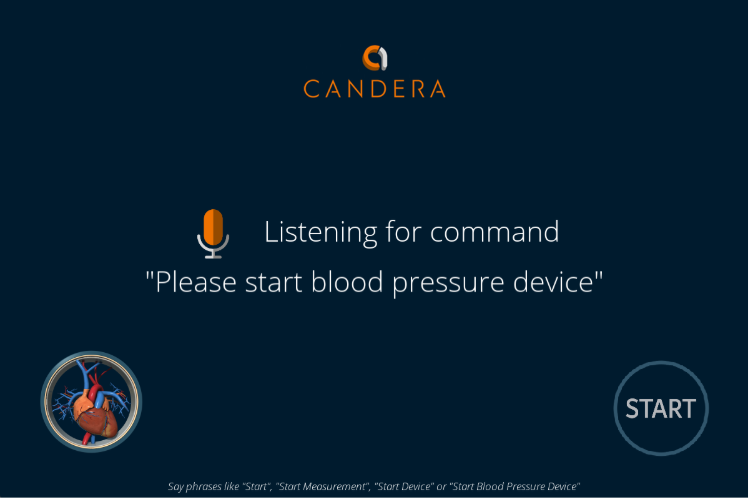

When the sample starts, it plays an intro animation and activates the menu scene. The menu scene is active util an according voice command like "Start",  "Start measurement", "Start blood pressure device", ...  was recorded. A live transcription of the voice input is displayed in the menu scene.

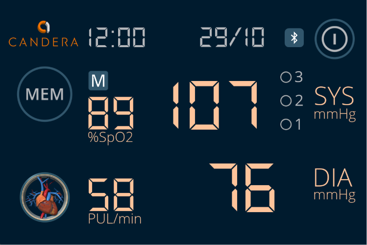

When the according voice command was received or the start button was pressed, the sample transitions to the blood pressure measurement scene. The measurement scene animates measurement values like oxygen saturation or heart rate gradually. An exemplary MEM button demonstrates a potential saving function of last measurements.
The values that can be seen in the above picture are set via Python by using the data binding library. A timer defined in the global state machine transitions back to the menu scene after 20 seconds.
