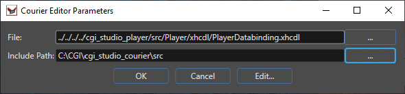

Because the data-source is defined in the Player, a connection between the Player and the Scene Composer Solution has to be defined. The following approach needs to be followed if data-binding should be used. Go to "File -> Define application specification". A window will pop up that requires two paths:
  • File: This is the path to the XHCDL file where the binding sources are stored.
  • Include Path: This is root path to the source of CGI Studio Courier.
After entering the paths the pop-up window should look similar to the following:
Press "OK" to save the specification. In the "Output"-panel a message will be shown if the specification is valid or not.

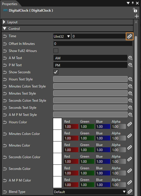

Drag the Control called "Digital Clock" into the home scene. The Control has some properties for customization. For instance the clock can be configured to show full 24 hours or just 12 hours with an "a.m." and "p.m." label. The text of those labels can be changed as well. The properties of the control look similar to this:

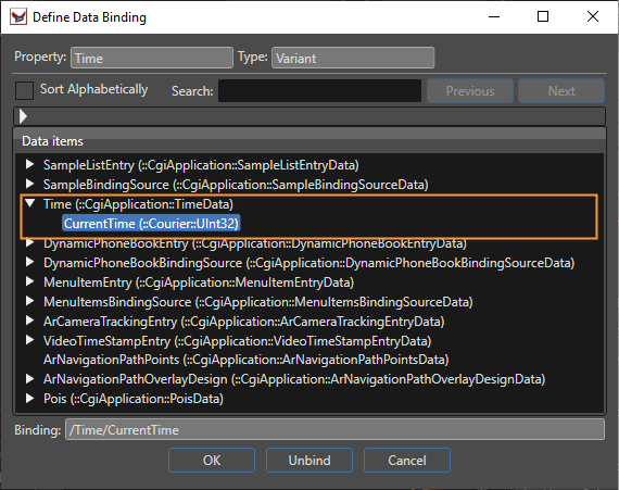

To add data-binding go to the Clock Control properties click on the chain icon on the right of the property "Time" to open the "Define Data Binding" dialog. For the property "Time" the datatype "Variant" is preselected, now the Binding Source can be chosen. Choose the Time binding source and click "OK". To find the binding source more easily, the dialog offers a search field. Define Data Binding dialog looks like this:
You can now generate a new asset library and try it out in the Player.
