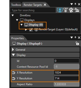

  2. Activate the Render Targets panel on the top right and select [ Display (0) ]. In the Properties panel below change the display's X and Y Resolution.
    • The horizontal and vertical resolution of the display will be defined.
    • The aspect ratio of the display will be calculated automatically.
      Target Item Setting Value
      X Resolution
      1024
      Y Resolution
      714768
