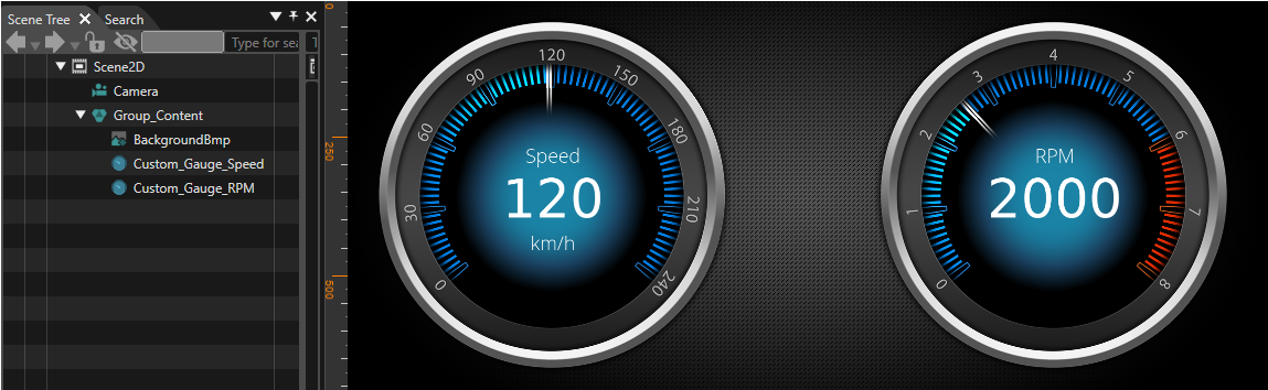

                      In the Scene Editor the gauge controls for RPM and Speed are both visible. The Scene2D starts to look like a cluster, see image below.
                      Custom_Gauge_RPM Property Value Transformation Position X 965.00 Position Y 30.00
                      Custom_Gauge_Speed Property Value Transformation Position X 60.00 Position Y 30.00 Control Value 120 Input Max 240 Top_Text Speed Value_Format Text %d Bottom_Text km/h BackgroundImage Solution/Resources/Bitmaps/Points_BlueBmp ForegroundImage Solution/Resources/Bitmaps/Numbers_0-240Bmp
