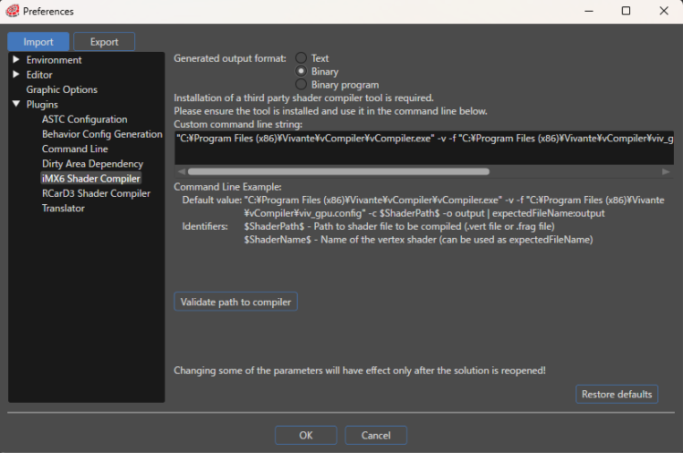

#### <a class="anchor" id="bkmrk--6"></a>iMX6 Shader Compiler
iMX6ShaderCompiler provides support for exporting compiled (and/or linked) shaders to the asset file.
<div drawio-diagram="8904"><img src="https://doc316en.candera.eu/uploads/images/drawio/2026-01/drawing-7-1768276833.png" alt=""/></div>
<div class="contents" id="bkmrk--3"><div class="contents"></div></div>It can be configured from File/Preferences section and provides some parameters which can be changed in order to achieve the desired behavior:
1\. Output type:
<div class="contents" id="bkmrk-a.-binary---exports-"><div class="contents"><div class="textblock">
- a. Binary - exports compiled shaders (separate compiled vertex and fragment shaders)
- b. Binary program - exports a linked shader pair (in the asset file, the vertex shader will contain the compiled and linked pair and the fragment shader will contain an empty buffer)
- c. Text - exports the source code of the shaders (separate source code for vertex and fragment shaders)
</div></div></div>2\. Command line - a configurable string of the following format:
<path_to_executable_file> [arg0] [arg1] [arg2] ... [argN] | expectedFileName:<output_file_name>
<div class="contents" id="bkmrk-a.-the-path-to-execu"><div class="contents"><div class="textblock">
- a. The path to executable to be run in order to generate the compiled/linked shaders along. The executable itself can be specified alone (no path) if the path to it's parent directory is found in the system environment path. Paths which cointain spaces need to be delimited by double quotes. Example: "C:\\My Projects\\Vivante\\vCompiler.exe" <dl class="note"><dt></dt><dd><p class="callout info">If vCompiler.exe is not available, in order to avoid an error related to the executable file missing, for host assets the output format for the generated shaders can be set to text. For more information related to vCompiler please check <span style="color: rgb(230, 126, 35);">[vCompiler](https://doc316en.candera.eu/books/target-setup-for-imx6-with-qnx-os/page/imx6-prerequisites)</span></p>
    </dd><dd></dd></dl>
- b. The arguments (parameters to be passed to execution). Some special parameters which identify the current processed shader can be specified (they are detailed below). Examples: $ShaderPath$, $VsPath$
- c. The expected file name specifier: specifies the name (without extension) of the output file and is separated from the rest of the command (a and b) by a pipe '\|'. iMX6 shader compiler expects output files with the following extensions: i.) .vgcSL - compiled vertex shader (applies for Binary output only) ii.) .pgcSL - compiled fragment shader (applies for Binary output only) iii.) .gcPGM - compiled and linked shader pair (applies for Binary program output only)
</div></div></div>Example: For binary output, "expectedFileName:output" - requires that a compiled vertex shader file will be named output.vgcSL and a compiled fragment shader file will be named output.pgcSL
The command line for "Binary" output is a little bit different than the one for "Binary program" output.
Binary output command line: this command line is invoked separately for each vertex and fragments shader.
Example: "C:\Vivante\vCompiler.exe" -s4 -c $ShaderPath$ -o output | expectedFileName:output
**Identifiers**
<div class="contents" id="bkmrk-%24shaderpath%24---can-b"><div class="contents"><div class="textblock">
- $ShaderPath$ - can be used as argument only and this identifier will be replaced with actual path to shader file when the command is invoked
- $ShaderName$ - can be used as expectedFileName specifier and will be replaced with the shader name (without extension) when the command is invoked
</div></div></div>Binary program output command line:
This command is invoked for a shader pair (both vertex and fragment shader)
Example: "C:\Vivante\vCompiler.exe" -v $VsPath$ $FsPath$ -o output | expectedFileName:output
**Identifiers**
<div class="contents" id="bkmrk-%24vspath%24---can-be-us"><div class="textblock">
- $VsPath$ - can be used as argument only and will be replaced with actual path to vertex shader file when the command is invoked
- $FsPath$ - can be used as argument only and will be replaced with actual path to fragment shader file when the command is invoked
- $VsName$ - can be used as expectedFileName specifier and will be replaced with the vertex shader name (without extension) when the command is invoked
</div></div>
