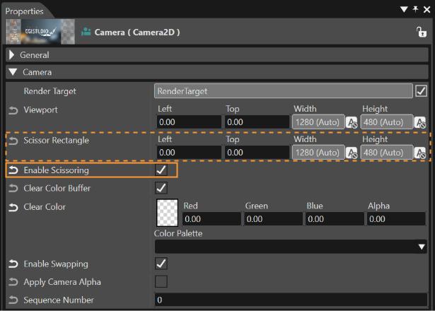

#### Automatically Tick Camera
If enabled, Camera rendering will be automatically enabled when a Camera is linked to a Render Target. Also, this setting only applies to Camera that are newly linked to Render Target, and does not affect the settings of Cameras that are already linked to Render Target.

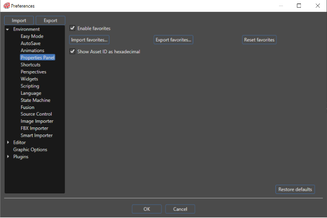

# Properties Panel - Favorites
<div drawio-diagram="5249"><img src="https://doc316en.candera.eu/uploads/images/drawio/2024-02/drawing-5-1708076766.png" alt=""/></div>
#### Enable favorites
You can save any property as a favorite property.
##### Add / Remove Properties to Favorites

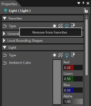

Any property can be saved as a favorite property just by right-clicking on it, after the favorites are enabled. A "Favorites" category will appear in the Properties, where you can see all the selected favorite properties.
<div drawio-diagram="6482"><img src="https://doc316en.candera.eu/uploads/images/drawio/2024-07/drawing-5-1721996082.png" alt=""/></div>
Right click on a property in the "Favorites" category and select "Remove from Favorites" in the context menu to remove a single one.
<div drawio-diagram="6483"><img src="https://doc316en.candera.eu/uploads/images/drawio/2024-07/drawing-5-1721996134.png" alt=""/></div>
#### Import favorities... / Export favorities...
Use "Export favorites..." in the "Environment - Property" section for saving all the selected favorite properties on a chosen location (as an .XML document). Any exported .XML favorites document could be imported by using the "Import favorites..." button from the "Environment - Properties panel" section.
#### Reset favorites
The "Reset favorites" button in the "Environment - Properties" panel section allows to reset all the available favorite properties.

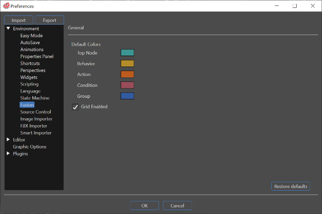

# Fusion
In the Preferences \[ Environment \] &gt; \[ Fusion \], you can configure settings related to the display in the Fusion panel.
<div drawio-diagram="6491"><img src="https://doc316en.candera.eu/uploads/images/drawio/2024-07/drawing-5-1721997234.png" alt=""/></div>
#### General
<table border="1" id="bkmrk-default-colors-you-c" style="border-collapse: collapse; width: 100%;"><colgroup><col style="width: 23.115%;"></col><col style="width: 76.885%;"></col></colgroup><tbody><tr><td>Default colors</td><td><span style="color: rgb(0, 0, 0);">You can configure the color of the newly created Fusion nodes displayed on the Fusion panel. </span>
<span style="color: rgb(0, 0, 0);">Changing default color do not attached already created nodes, however those color will be used when user will call "<span style="color: rgb(230, 126, 35);">[Restore Default Header Color](https://doc316en.candera.eu/link/1060#bkmrk-lock-performs-an-edi)</span>" command from context menu.</span>
</td></tr><tr><td>Grid Enabled</td><td>When this option is enabled, there are grids in <span style="color: rgb(230, 126, 35);">[Fusion panel](https://doc316en.candera.eu/books/fusion/page/fusion-editor-ui)</span>.</td></tr><tr><td><span style="color: rgb(0, 0, 0);">Restore Defaults</span></td><td>Pressing this button will return all settings to their default settings.</td></tr></tbody></table>

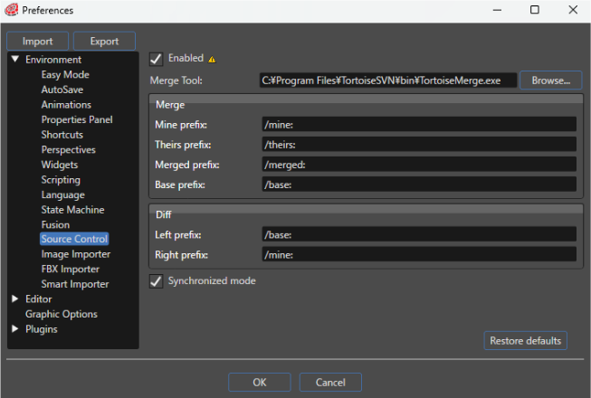

# Configure Source Control
#### Configure Source Control
It is necessary to configure an external tool when you're working with a solution from repository, using the source control offered by SceneComposer.
To do this open the Preferences dialog (from "File" &gt; "Preferences") where you can specify the external tool that will be used and specific commands for "Merge" and "Diff" operations. Before any of these operations, the merge tool has to be enabled by using the available check-box.
<div drawio-diagram="8512"><img src="https://doc316en.candera.eu/uploads/images/drawio/2025-08/drawing-7-1754290511.png" alt=""/></div>
<table border="1" id="bkmrk-%E6%9C%89%E5%8A%B9-%E6%9C%89%E5%8A%B9%E3%81%AE%E5%A0%B4%E5%90%88%E3%81%AF%E3%80%81%E3%83%9E%E3%83%BC%E3%82%B8%E3%83%84%E3%83%BC%E3%83%AB%E3%81%AE%E4%BD%BF%E7%94%A8%E3%81%8C" style="border-collapse: collapse; width: 89.881%;"><colgroup><col style="width: 19.8899%;"></col><col style="width: 80.1101%;"></col></colgroup><tbody><tr><td>Enabled</td><td>If enabled, the use of a merge tool is enabled.</td></tr><tr><td>Merge Tool</td><td>Sets the merge tool to use.</td></tr><tr><td>Merge</td><td>Specifies the command for merge operations.</td></tr><tr><td>Diff</td><td>Specifies the command for diff operations.</td></tr><tr><td>Synchronized mode</td><td>If enabled, will assure that the solution status is always retrieved from the server by default. Communication with the server is a time consuming operation that's why you can also decide not to use this option and perform an explicit "Refresh status" operation from the source control context menu (only if necessary). </td></tr></tbody></table>
<p class="callout info">The value of the check-box is evaluated only when a solution is opened or created.</p>

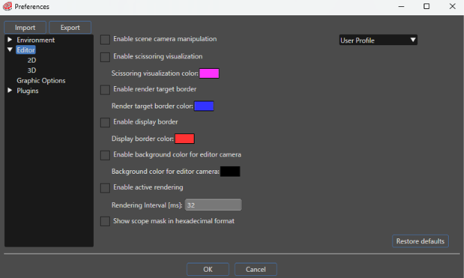

General Editor options can be found in "File" &gt; "Preferences" section "Editor".
<div drawio-diagram="8617"><img src="https://doc316en.candera.eu/uploads/images/drawio/2025-10/drawing-7-1760596615.png" alt=""/></div>
#### Enable scene camera manipulation
"Enable scene camera manipulation" enables the manipulation of the scene's cameras via the Scene Render panel. The cameras can be manipulated via navigation panel or using the appropriate shortcut commands (hot keys) combined with mouse operations when a scene camera is selected from the scenes combobox' from Toolbar.

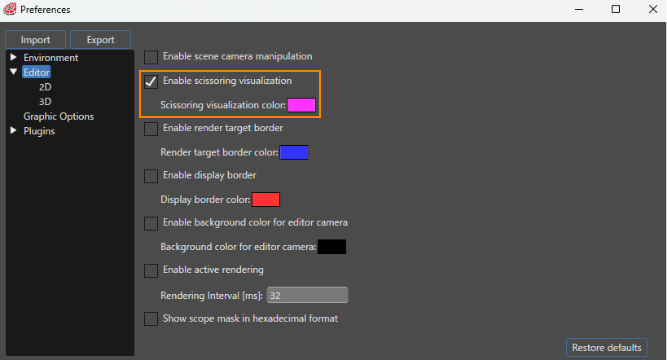

##### Enable scissoring visualization
By using this feature all the pixels which are outside of the intersection area of the viewport and scissor rectangle can be clipped. After the activation of this feature the scissor rectangle's values have to be defined. This rectangle specifies a region within the Camera's RenderTarget. The rectangle's width and height values must be greater than 0. These values can be set on the Camera's Properties panel.
<div drawio-diagram="6534"><img src="https://doc316en.candera.eu/uploads/images/drawio/2024-08/drawing-5-1724393084.png" alt=""/></div>
By using the "Scissoring visualization color" a desired color can be chosen and its transparency can be set.
<div drawio-diagram="8622"><img src="https://doc316en.candera.eu/uploads/images/drawio/2025-10/drawing-7-1760600101.png" alt=""/></div>
The chosen color can be saved to keep its info.
![image.png](https://doc316en.candera.eu/uploads/images/gallery/2023-07/scaled-1680-/ED1image.png)
This feature allows the visualization of the scissoring rectangle in the display window as in the next figure.
<div drawio-diagram="6535"><img src="https://doc316en.candera.eu/uploads/images/drawio/2024-08/drawing-5-1724397484.png" alt=""/></div>

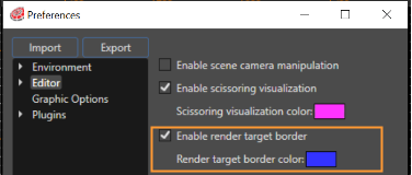

##### Enable render target border
By checking the "Enable Render Target Border" box (which is available in Preferences &gt; Editor, General Selection), the border of a render target can be colored. Any desired color can be chosen in the Color Palette.
<div drawio-diagram="4060"><img src="https://doc316en.candera.eu/uploads/images/drawio/2023-07/drawing-5-1688744413.png" alt=""/></div>
In this way, it is possible to see the borders of the RenderTargets graphically as colored rectangles.
<div drawio-diagram="6537"><img src="https://doc316en.candera.eu/uploads/images/drawio/2024-08/drawing-5-1724400286.png" alt=""/></div>

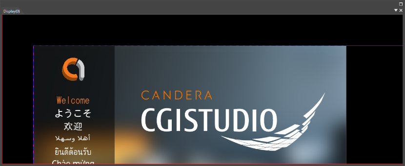

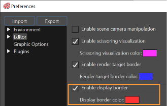

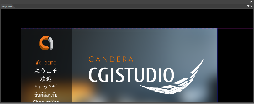

##### Enable display border
It is possible to visualize the Display border by enabling this feature. In Preferences dialog - Editor, the "Enable display box" should be checked. By using the "Display border color" a desired color can be chosen and its transparency can be set.
<div drawio-diagram="6538"><img src="https://doc316en.candera.eu/uploads/images/drawio/2024-08/drawing-5-1724400390.png" alt=""/></div>
After this feature is enabled, the borders of the display can be graphically seen as a colored rectangle.
<div drawio-diagram="6539"><img src="https://doc316en.candera.eu/uploads/images/drawio/2024-08/drawing-5-1724400468.png" alt=""/></div>

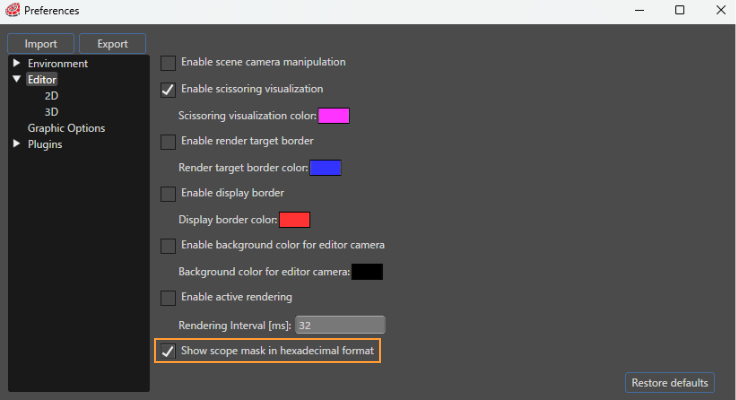

#### Show Scope Mask in Hexadecimal Format
The option "Show scope mask in hexadecimal format", when it is enabled, ensures that the values for Scope property will be displayed in hex in the Properties panel. This option is available in the Preferences dialog opened from "File" &gt; "Preferences" menu, section Editor.

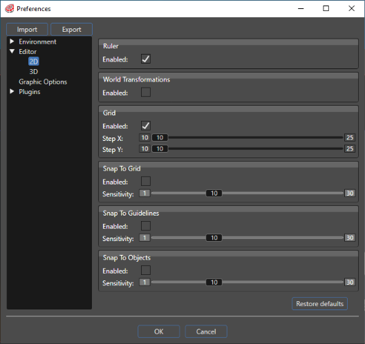

The SceneComposer offers a set of editing helpers that allow editing 2D scenes as simple and intuitive as possible.
All editing aids which have a visual presentation are configurable so that the user can disable them easily if not desired. This can be done from the dialog that opens from "File" &gt; "Preferences" menu under the "Editor" node, the "2D" option.
<div drawio-diagram="6543"><img src="https://doc316en.candera.eu/uploads/images/drawio/2024-08/drawing-5-1724401581.png" alt=""/></div>
In 2D scenes, SceneComposer offers the following entries in the 2D section of Editor-Preferences:
- Ruler
- World Transformations
- Grid
- Snap to Grid
- Snap to Guidelines
- Snap to Objects

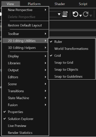

You can also find some 2D Editing Aids in the "View" menu in section "2D Editing Utilities".
<div drawio-diagram="6545"><img src="https://doc316en.candera.eu/uploads/images/drawio/2024-08/drawing-5-1724401678.png" alt=""/></div>

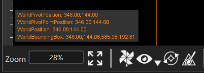

#### World Transformations
To use the **World Transformations**, enable this option and select an object in the Scene Editor Window. Now,a tooltip is displayed in the lower left corner of the Scene Editor that shows absolute coordinates and sizes.
<div drawio-diagram="6546"><img src="https://doc316en.candera.eu/uploads/images/drawio/2024-08/drawing-5-1724401872.png" alt=""/></div>
The following values are displayed:
- **WorldPivotPosition**: horizontal value, vertical value
- **WorldPivotPointPosition**: horizontal value, vertical value
- **WorldPosition**: horizontal value, vertical value
- **WorldBoundingBox**: horizontal value, vertical value, width, height

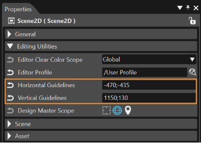

**Guidelines**
- Guidelines are created in SceneComposer by click and drag from the ruler. In order to be removed, a guideline is dragged outside the view.
- Multiple guidelines can be drawn in a scene and they are bound to a scene and not camera viewport.
- The configured guidelines are visible and editable in the scene's properties.

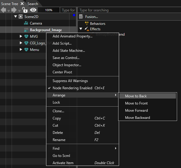

This feature allows the user to manipulate objects such that they can be placed on top-most level, or sent to background. Layering is done through a property called DepthValue, in a range of 0..255.
The following operations are available:
- **Move back**: increase depth value by 1
- **Move front**: decrease depth value by 1
- **Move to back**: set depth value to 255
- **Move to front**: set depth value to 0
<div drawio-diagram="7613"><img src="https://doc316en.candera.eu/uploads/images/drawio/2024-12/drawing-5-1733490211.png" alt=""/></div>
You can manipulate these values from the context menu, or by setting the value of property DephValue from Properties panel.
- Candera 2D doesn't specify a rule for rendering objects that have the same depth value.
- There might be X objects with depth value 0 (top-most), but only one object of those ones is rendered topmost.
- Conflicts at the interval end (0 or 255) have to be handled.

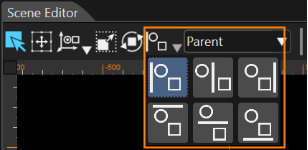

**Object alignment (top, middle, bottom, left, center, right / relative to other objects)**
This feature enables automatically re-positioning of objects such that they are aligned on a specific criterion. Only render nodes and groups are eligible for alignment and this feature applies to a selection consisting of at least 2 render nodes and/or groups.
<p class="callout info">First selected object serves as reference for alignment.
</p>
The object alignment feature is available for the 2D scenes by selecting the appropriate button from the Toolbar. Each button corresponds to a criterion of alignment.
<div drawio-diagram="6549"><img src="https://doc316en.candera.eu/uploads/images/drawio/2024-08/drawing-5-1724402302.png" alt=""/></div>
##### Available criteria
- **Top/bottom alignment**: the selected objects (excluding the reference one) will be positioned such that the top/bottom side of their rendering area is aligned to the top/bottom side of the first object's rendering area.
- **Left/right alignment**: the selected objects (excluding the reference one) will be positioned such that the left/right side of their rendering area is aligned to the left/right side of the first object's rendering area.
- **Center alignment**: the selected objects (excluding the reference one) will be positioned such that their rendering area's geometric center is aligned to the geometric center of the first object's rendering area.
- **Middle alignment**: the selected objects (excluding the reference one) will be positioned such that their rendering middle is aligned to the middle of the first object's rendering area

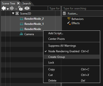

#### Groups
For grouping elements on the same level add a group to the selected objects as parent if they are on the same level. From the SceneTree panel, keep Ctrl key pressed and select more objects. On the last object that is desired to be part of the group press right click and select the option "Create group" from the context menu.
<div drawio-diagram="7614"><img src="https://doc316en.candera.eu/uploads/images/drawio/2024-12/drawing-5-1733490322.png" alt=""/></div>

##### Exact Camera View in Scene Editor
"Exact Camera View" menu option will make the camera from the scene to ignore the current aspect ratio of the scene render.
- When Exact Camera View is disabled the view of the active camera is stretched on the available rendering surface.
- When Exact Camera View is enabled, SceneComposer makes additional computations on the camera so that the camera view image does not get distorted on the scene rendering panel.
- Using this mode may lead to different output compared to the rendering output on display (the display on which the camera renders).

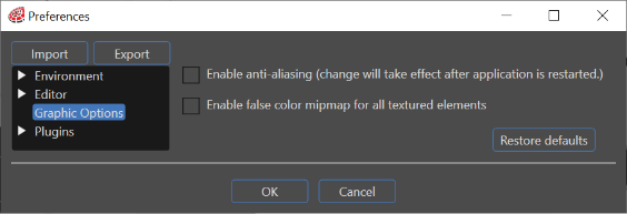

# Graphic Options
# Anti-Aliasing
#### Enable anti-aliasing
Enables anti-aliasing effect.
Anti Aliasing is a technique of adjusting pixel positions or setting pixel intensities so that there is a more gradual transition between the color of a line and the background color in order to give a smoother appearance of the object. The image bellow illustrates the Antialiasing effect on an object.
<div drawio-diagram="617"><img src="https://doc316en.candera.eu/uploads/images/drawio/2023-02/drawing-7-1676365018.png" alt=""/></div>
<div drawio-diagram="6587"><img src="https://doc316en.candera.eu/uploads/images/drawio/2024-08/drawing-5-1724412635.png" alt=""/></div>
<p class="callout info">The changing of the anti aliasing will only take effect after the application is restarted.</p>
