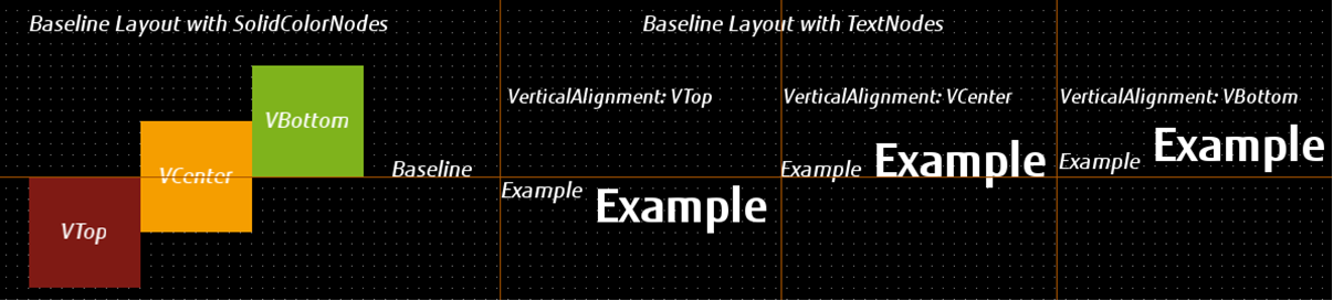

The Baseline Layouter realizes a stacked layout in the horizontal direction. It behaves similar to the Horizontal Stack Layouter but it aligns the objects to a line instead of aligning them to the client area. This layouter offers a property Base Line Offset to configure the position of the Baseline. The main purpose of this layouter is to align texts with different sizes in various ways. Elements can be aligned along the top (VTop), the center (VCenter) or the bottom (VBottom) of their bounding boxes, which can be configured with the child elements’ Vertical Alignment property.
The order of the elements is given by the order of the child nodes within the laid out group.
<div drawio-diagram="2774"><img src="https://doc316en.candera.eu/uploads/images/drawio/2023-02/drawing-4-1677546464.png" alt=""/></div>
<div class="contents" id="bkmrk--4"><div class="contents"><div class="textblock">
</div></div></div>After selecting the Baseline Layouter, an additional layout property Base Line Offset becomes available. Using this property, the baseline can be set to a fixed position within the client area. Setting the baseline offset to a negative value (e.g. -1) configures the baseline for automatic, which means, the baseline is automatically set to a position where all children are positioned below the top of the client area. The Base Line Offset property is not only available to the Baseline Layouter, but also its child objects. The property can be found under the layout section in the properties panel.
<div drawio-diagram="2777"><img src="https://doc316en.candera.eu/uploads/images/drawio/2023-02/drawing-4-1677546522.png" alt=""/></div>
<div class="contents" id="bkmrk--6"><div class="contents"><div class="textblock">

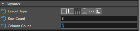

This layouter allows you to define a grid, assign nodes to the grid cells and layout these nodes to fit into the cells. If you select the grid layouter for a node, the properties for Row Count and Column Count can be configured in the properties panel.
<div drawio-diagram="2778"><img src="https://doc316en.candera.eu/uploads/images/drawio/2023-02/drawing-4-1677546542.png" alt=""/></div>
<div class="contents" id="bkmrk--10"><div class="contents"><div class="textblock">

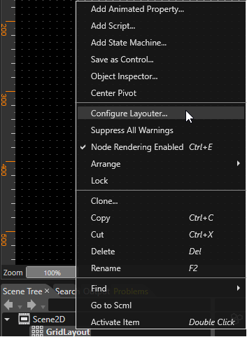

</div></div></div>Additionally, the context menu for the grid layout node (right-click on the specific grid layout) is extended by the entry Configure Layouter.
<div drawio-diagram="2779"><img src="https://doc316en.candera.eu/uploads/images/drawio/2023-02/drawing-4-1677546554.png" alt=""/></div>
<div class="contents" id="bkmrk--12"><div class="contents"><div class="textblock">

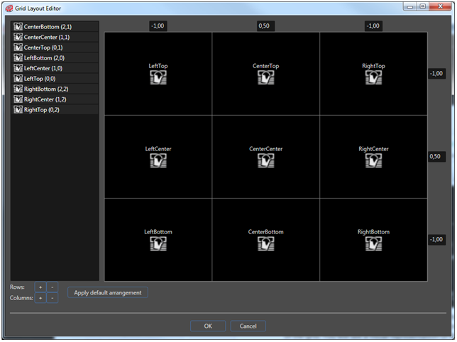

</div></div></div>After choosing this context menu entry the Grid Layout Editor will open.
<div drawio-diagram="2780"><img src="https://doc316en.candera.eu/uploads/images/drawio/2023-02/drawing-4-1677546575.png" alt=""/></div>
<div class="contents" id="bkmrk--14"><div class="contents"><div class="textblock">
</div></div></div>On the left side there is a list of nodes that can be assigned to the cells. Each cell shall contain only one node. At the bottom you can increase/decrease the number of rows/columns of the grid. You will see a visual representation of the grid and the assigned nodes in the center. The width of the columns and height of the rows can be configured at the top and on the right side. The value -1 means that it is flexible and the remaining area will be distribute by the grid layouter. Values larger than or equal to 1.0 are absolute values. The grid layouter will use exactly this size for the column/row and reduce the remaining area by this value. Values below 1.0 are relative values. In the sample above, the center row will receive 50% of the remaining height (after all absolute values have been considered) and the center column will receive 50% of the remaining height.
<div class="contents" id="bkmrk-relative-values-will"><div class="contents"><div class="textblock"><dl class="note"><dt></dt><dd><p class="callout info">Relative values will be normalized. This means, since a configuration of e.g. 0.1, 0.3 and 0.1 doesn’t sum up to 1.0, the values will be recalculated. The sum of all relative values is 0.5, so the relative value of 0.1 will be normalized with 0.1/0.5, which results in 0.2. So this part of the grid will get 20% of the available space.</p>
</dd></dl></div></div></div>A child node can be configured to span over multiple cells using its layout properties Row Span or Column Span. Here is an example on a Grid Layout configuration in CGI Studio with various cells using the column span and row span properties:

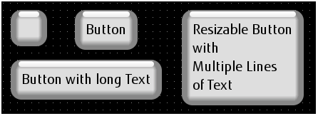

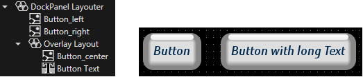

</div></div></div>##### <a class="anchor" id="bkmrk--58"></a>Use Cases
A button that can grow with the length of its text can be configured as follows with CGI Studio Layouters:
<div drawio-diagram="2785"><img src="https://doc316en.candera.eu/uploads/images/drawio/2023-02/drawing-4-1677546662.png" alt=""/></div>
<div class="contents" id="bkmrk--24"><div class="contents"><div class="textblock">
</div></div></div>The DockPanel Layouter contains a node for the left of the button (docked left), a node for the right of the button (docked right) and an Overlay Layouter for the background of the button and the button’s label. The Button\_center node’s stretch behavior is set to Fill, so that the image is resized automatically when the button’s label is changed. The text node as foreground should be aligned to vertical and horizontal center.

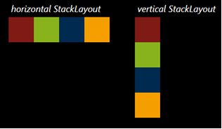

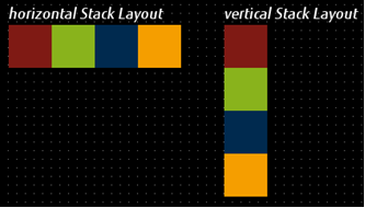

The Stack Layouter stacks the nodes on top of each other under consideration of their preferred size. The additional Arrangement property will be shown in the properties panel as soon as you switch to a Stack Layouter. You can choose to configure horizontal or vertical stacking (horizontal is the default). There are no additional properties at child node level for this layouter.
<div drawio-diagram="2786"><img src="https://doc316en.candera.eu/uploads/images/drawio/2023-02/drawing-4-1677546678.png" alt=""/></div>
<div class="contents" id="bkmrk--26"><div class="contents"><div class="textblock">
</div></div></div>Here is an example of a horizontal and a vertical Stack Layout using the CGI Studio Stack Layouter.
<div drawio-diagram="2787"><img src="https://doc316en.candera.eu/uploads/images/drawio/2023-02/drawing-4-1677546688.png" alt=""/></div>
<div class="contents" id="bkmrk--28"><div class="contents"><div class="textblock">
</div></div></div>#### <a class="anchor" id="bkmrk--63"></a>Similar to WPF StackPanel

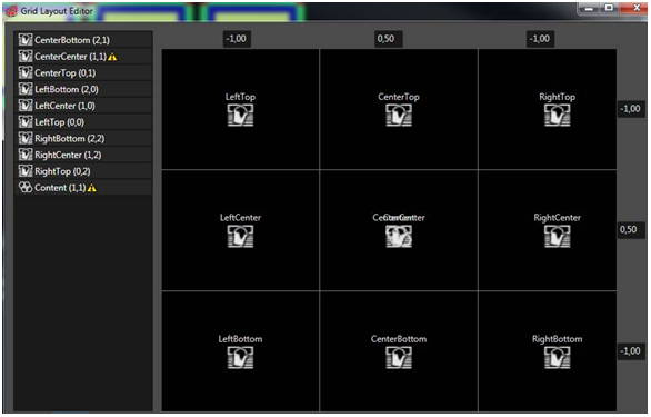

#### <a class="anchor" id="bkmrk--30"></a>CGI Studio Solution
With CGI Studio, the same has been done, but instead of a Grid Layout for the Content, an Overlay Layouter has been used, that consumes less resources.
<div drawio-diagram="2804"><img src="https://doc316en.candera.eu/uploads/images/drawio/2023-02/drawing-4-1677547144.png" alt=""/></div>
<div class="contents" id="bkmrk--12"><div class="contents"><div class="textblock"></div></div></div>The configuration of the Grid Layouter is mapped like this:
<div drawio-diagram="2805"><img src="https://doc316en.candera.eu/uploads/images/drawio/2023-02/drawing-4-1677547157.png" alt=""/></div>
<div class="contents" id="bkmrk--14"><div class="contents"><div class="textblock"></div></div></div>#### <a class="anchor" id="bkmrk--33"></a>Comparison
WPF row/column auto configuration is the same as the values -1 for the row height/column width configuration in CGI Studio. The WPF row/column fraction configuration (“\*”) maps to any value greater than 0 and less than 1 for the row/column configuration in CGI Studio. In the sample 0.5 is configured for the center row height/column width. Note that this is not a percentage value, it is a fraction.
<div class="contents" id="bkmrk-not-used-in-this-exa"><div class="contents"><div class="textblock"><dl class="note"><dt></dt><dd><p class="callout info">Not used in this example, however noted for the sake of completeness: The WPF row/column fixed size configuration (e.g. “10”) maps to the same value for the row/column configuration in CGI Studio, where all values greater than 1 are absolute values in pixel.
WPF has some bugs in the WPF grid when it comes to column/row span that contain fixed size rows/columns or fraction rows/columns (for the fraction it is even possible that the item does not fit into the span).</p>
</dd></dl></div></div></div>#### <a class="anchor" id="bkmrk--34"></a>Conclusion
The solution using an overlay seems to be the approach that needs the minimum number of nodes. However, it requires the most content related configuration, the reason being that the size of the border primitives (WPF rectangle and CGI Studio RenderNode with SolidColorBrush) have to be reflected by the margins of some items. This applies for both WPF and CGI Studio. From the number of nodes point of view the grid approach comes next in the row. However, the grid layout uses the most resources of the considerable layouters: it is not a singleton and uses some internal data structures to perform the layout. The solution with the dock panel layouter uses the highest number of nodes. But, it adapts very flexible to the content, is a singleton and – like the overlay layout - requires only one pass to layout.
