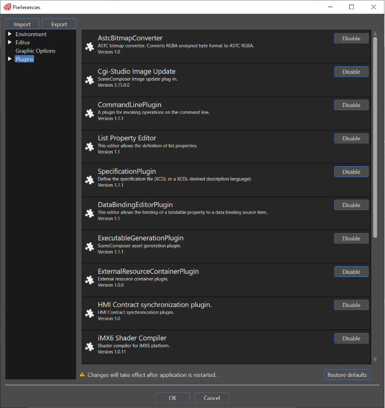

#### <a class="anchor" id="bkmrk--1"></a>Plugins Configuration
The version of every available plugin is displayed in "Preferences" &gt; "Plugins" under the name of the plugin (the right side of the panel).
<div drawio-diagram="6596"><img src="https://doc316en.candera.eu/uploads/images/drawio/2024-08/drawing-5-1724416539.png" alt="drawing-5-1724416539.png"/></div>
