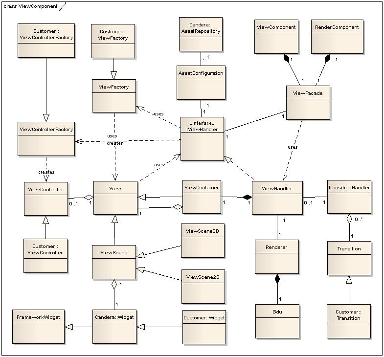

As you can see, the SampleApp example only derives two standard [Courier](http://dev.doc.cgistudio.at/APILINK/namespace_courier.html) classes:
<div class="contents" id="bkmrk-courier%3A%3Aviewfactory"><div class="contents"><div class="textblock">- [Courier::ViewFactory](http://dev.doc.cgistudio.at/APILINK/class_courier_1_1_view_factory.html): to control how views and view containers are created and destroyed
- [Courier::ControllerComponent](http://dev.doc.cgistudio.at/APILINK/class_courier_1_1_controller_component.html): to implement application-specific message handling
<dl class="note"><dt>
</dt><dd><p class="callout info">There are standard render components for 3D only, 2D only, as well as 3D and 2D available.</p>
<p class="callout info">Take care to use the render component appropriate to the content to be rendered.</p>

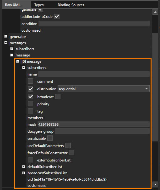

#### **Message Generation**
##### <a class="anchor" id="bkmrk--13"></a>Generating Application Messages
In the sample application some specific messages are used. The messages are usually defined in XCMDL files and don't have to be implemented manually. The [Courier](http://dev.doc.cgistudio.at/APILINK/namespace_courier.html) generation tool (located at "\\cgi\_studio\_courier\\bin") is using this description xml file and is generating a CPP / H file pair. In our case SampleAppMsgs.xcmdl will result in the generation of SampleAppMsgs.cpp and SampleAppMsgs.h files.
        <message distribution="sequential" name="SpeedMsg" tag="none" uid="{EE4C2D20-35E3-4589-9F48-AC665A1EA9B1}">
            <subscribers>
                <subscriber id="Model" />
            </subscribers>
            <member name="Speed" type="Courier::UInt32" uid="{774A1E76-E6E6-4B95-A3E7-8A809C83BE34}"></member>

**Message Distribution**
The message distribution is consequently a deterministic order throughout the [Courier](http://dev.doc.cgistudio.at/APILINK/namespace_courier.html) components. At the top level there are one or more message receivers, which have one or more components attached.
The [Courier::ViewComponent](http://dev.doc.cgistudio.at/APILINK/class_courier_1_1_view_component.html) is a specialized [Courier::Component](http://dev.doc.cgistudio.at/APILINK/class_courier_1_1_component.html) and <span style="color: rgb(230, 126, 35);">[View Tree](https://doc316en.candera.eu/link/577#bkmrk-view-tree)</span> explains how messages are routed through this component.

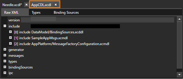

# Data Binding: Quick Start

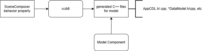

CGI Studio uses data binding to connect data with behavior properties. The connection can be configured inside CGI Studio Scene Composer through an xml file that defines binding sources. This same xml file is used by the Model Component to set/get data.
<div drawio-diagram="8430"><img src="https://doc316en.candera.eu/uploads/images/drawio/2025-05/drawing-4-1748593370.png" alt=""/></div>
### Creating the Binding Sources
An xcddl (xml) file must first be created to bind the asset in SceneComposer with the application. This same xcddl file is also used to generate code that will be used by the Model Component of the application.

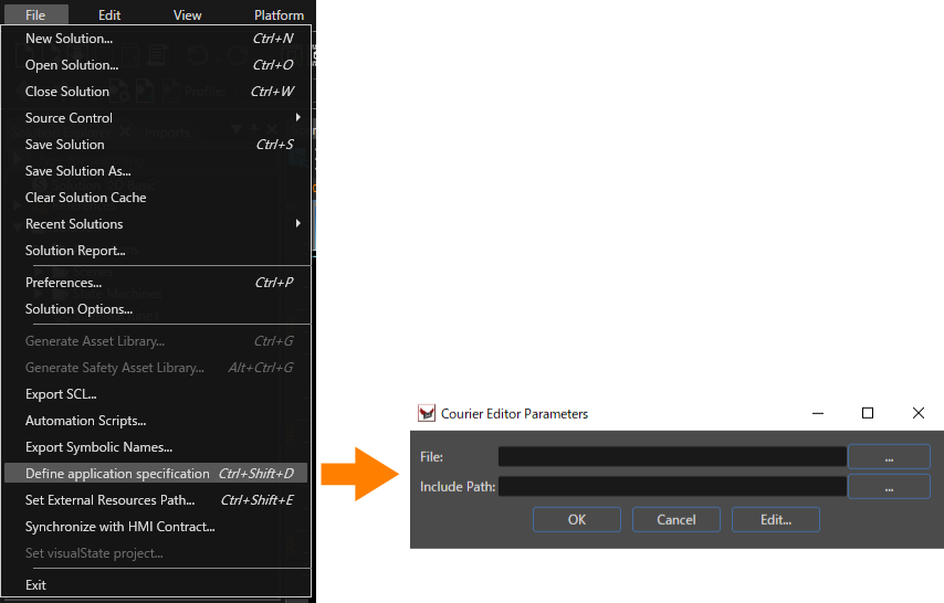

- Use the **Courier Editor.exe** found in<span style="color: rgb(236, 240, 241);"> <span style="background-color: rgb(255, 255, 255); color: rgb(0, 0, 0);">&lt;CGI Studio&gt;\\cgi\_studio\_courier\\bin\\</span></span> to generate an xcddl file. This will contain the data binding sources.
    - A **binding source** is a collection of data items.
    - Data items are grouped according to logical interdependencies, update frequencies, etc.
    - Scene Composer also reads the XCDDL file to bind behavior properties to data items.
```xml
  <bindingSources>
    <bindingSource uid="{ed8e107f-8e21-45d0-805e-99891f6a75a6}" name="CustomData" access="asynchronous">
      <item uid="{7ff9385a-15d9-4cff-852a-fc03c8f841da}" name="CustomValueItem1" type="FeatStd::UInt16" />
      <item uid="{150e6f31-8d88-4d8a-9a2b-7afafa968c83}" name="CustomValueItem2" type="FeatStd::UInt16" />
    </bindingSource>
  </bindingSources>

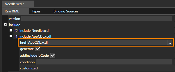

- The generated xcddl files must be included in the **AppCDL.xcdl.** For example "CustomDataModel.xcddl" was generated, then it should be included like below:
<include href="DataModel/CustomDataModel.xcddl" generate="true" />
### Creating the Model Component
- Next step is to convert xcddl file to C++ code using **Courier Generator.exe** found in &lt;CGI Studio&gt;\\cgi\_studio\_courier\\bin\\
- Create ModelComponent class derived from **Courier::ModelComponent.** Add the generated DataBindingSource inside a DataItemContainer as member. The "CustomDataDataBindingSource" is typically generated in **AppCDL.h**.

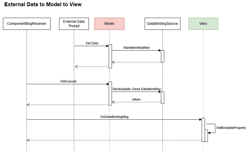

### Model to View
In databinding, data goes both ways. If any data in the Model Component is changed, all connected Behaviors in the View will be informed of this change. Likewise if the behavior changes the data, the Model Component will be notified.
The sequence diagram from external Data -&gt; Model -&gt; View is shown below:
<div drawio-diagram="8431"><img src="https://doc316en.candera.eu/uploads/images/drawio/2025-05/drawing-4-1748593389.png" alt=""/></div>
**1. Provide setters to allow data to be set externally. Make sure it is thread-safe. Call MarkItemModified() to mark a certain data item that was changed.**
<p class="callout info">**MarkItemModified()** will mark item with the given key as modified.</p>
```c++
  void CustomModelComponent::SetCustomValue1(FeatStd::UInt16 value)
    FeatStd::Internal::CriticalSectionLocker lock(&m_criticalSection);
    (*m_customBindingSource).mCustomValueItem1 = value;
    if (!m_customBindingSource.MarkItemModified(ItemKey::CustomData::CustomValueItem1Item)) {
      FEATSTD_LOG_ERROR("failed to mark data binding item as modified!");
  void CustomModelComponent::SetCustomValue2(FeatStd::UInt16 value)
    (*m_customBindingSource).mCustomValueItem2 = value;
    if (m_customBindingSource.MarkItemModified(ItemKey::CustomData::CustomValueItem2Item)) {
**2. OnExecute, check if there are modified items, then call SendUpdate() to send update of the data to the View/Controller Component.**
<p class="callout info">**SendUpdate()** sends an update of the current data to the view/controller.</p>
```c++
  bool CustomModelComponent::OnExecute()
    if (m_customBindingSource.HasModifiedItems()) {
      if (!m_customBindingSource.SendUpdate()) {
        FEATSTD_LOG_ERROR("failed to send update for binding source!");
    return true;
**3. The View Component will receive the message asynchronously and set the properties.**

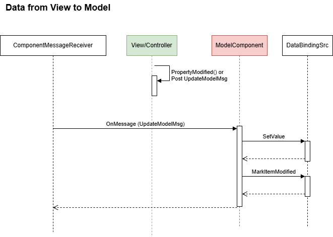

### View to Model
The sequence diagram from View -&gt; Model is shown below:
<div drawio-diagram="8432"><img src="https://doc316en.candera.eu/uploads/images/drawio/2025-05/drawing-4-1748593486.png" alt=""/></div>
**1. In the (View) behavior of the bindable property, when the property value has changed, invoke PropertyModified() to update the Model Component with the changed value. Or in the Controller, you may create and post an UpdateModelMsg to update the Model Component.**
<p class="callout info">To create a bindable property, define behavior properties with **CdaBindableProperty** instead of CdaProperty.</p>
<p class="callout info">**PropertyModified()** in the behavior will trigger so that the changed value is sent to the Model component.</p>
**2. OnMessage() of the Model Component, check for UpdateModelMsg and set the data accordingly ( using SetValue()) and MarkItemModified() ).**
```c++
  bool CustomModelComponent::OnMessage(const Courier::Message& msg)
    bool rc = false;
    switch (msg.GetId()) {
    case Courier::StartupMsg::ID:
      // initialize model here
      break;
    case Courier::UpdateModelMsg::ID: {
      Courier::UpdateModelMsg const* updateModelMsg = Courier::message_cast<const Courier::UpdateModelMsg*>(&msg);
      if (NULL != updateModelMsg) {
        for (FeatStd::SizeType i = 0U; i < updateModelMsg->RequestCount(); ++i) {
          Courier::Request request = updateModelMsg->GetRequest(i);
          switch (request.BindingSourceKey()) {
          case ItemKey::CustomDataItem: {
            if (!m_customBindingSource.SetValue(request.ItemKey(), request.GetItemValue())) {
              FEATSTD_LOG_ERROR("failed to set data binding!");
            if (!m_customBindingSource.MarkItemModified(request.ItemKey())) {
            break;
          default: break;
      break;
    default: break;
    return rc;
<p class="callout info">**UpdateModelMsg** is responsible to carry requests to modify or update data back from view/controller to the model component.</p>
Each UpdateModelMsg may contain multiple **Courier::Request** objects for multiple binding sources. Internally, UpdateModelMsg uses Courier::Internal::DataBinding::**ChangeSet** to store the request information.
The size of the buffer Courier::Internal::DataBinding::ChangeSet is using to store request data can be controlled with **COURIER\_CHANGE\_SET\_BUFFER\_SIZE**.

##### <a class="anchor" id="bkmrk--17"></a>Data Flow
Data is asynchronously distributed in the system with messages (see [Courier::DataItemMsg](http://dev.doc.cgistudio.at/APILINK/class_courier_1_1_data_item_msg.html)). Currently this is the only supported data access mechanism. Components receive data in [Courier::DataItemMsg](http://dev.doc.cgistudio.at/APILINK/class_courier_1_1_data_item_msg.html) messages. The components will hold a reference to the last received [Courier::DataItemMsg](http://dev.doc.cgistudio.at/APILINK/class_courier_1_1_data_item_msg.html) for each binding source. Thus components can read the latest data set synchronously from the message. If e.g. the view component opens a new View, the data for bound widget properties can be set immediately from the stored [Courier::DataItemMsg](http://dev.doc.cgistudio.at/APILINK/class_courier_1_1_data_item_msg.html) messages accordingly.
If the model receives new data, it will send the new set of data with a new [Courier::DataItemMsg](http://dev.doc.cgistudio.at/APILINK/class_courier_1_1_data_item_msg.html). The message not only carries modified, new data, but the complete set of the binding source data. For each data item the message carries a flag indicating if the item has been modified or not. For non-list data a single flag is sufficient information to indicate a change in data, for list data multiple types of changes may happen (e.g. adding, removing, modifying existing list items). Therefore additional information is necessary to inform controller and view about the nature of change. Courier::Internal::ListEventMsg is used to send list modification information from model to controller and view. [Courier::ListEventNotifier](http://dev.doc.cgistudio.at/APILINK/class_courier_1_1_list_event_notifier.html "List event notifier. Convenience function for model component implementation. The class exposes a ful...") take over the job of sending Courier::Internal::ListEventMsg.
Components (controller / view) can also modify data items sent by the model. Again modified data is sent back in messages to the model. The [Courier::UpdateModelMsg](http://dev.doc.cgistudio.at/APILINK/class_courier_1_1_update_model_msg.html "Update model message is responsible to carry requests to modify or update data back from view / contr...") messages are responsible to carry modified data items back to the model component. [Courier::UpdateModelMsg](http://dev.doc.cgistudio.at/APILINK/class_courier_1_1_update_model_msg.html "Update model message is responsible to carry requests to modify or update data back from view / contr...") may carry multiple requests to change or update data for multiple binding sources.
On reception of an UpdateModelMsg the model component inspects the requests and, if the requests are accepted, modifies model data accordingly.

Bindings between widget properties and data items are normally defined in SceneComposer.
In order to do this, the specification file (XCDL or a XCDL derived description file) must be set. This can be set in SceneComposer by going to *File/Define application specification* and setting the following:
<div class="contents" id="bkmrk-specification%3A-xcdl-"><div class="contents"><div class="textblock">- Specification: XCDL or a XCDL derived description file (e.g. *BindingSources.xcddl* for *CourierSampleApp* )
- Search path: *&lt;cgi\_studio\_root&gt;/cgi\_studio\_courier/src*
</div></div></div>After these settings are made, the **Binding Property** of the widget must be set according to the requirements of the application.

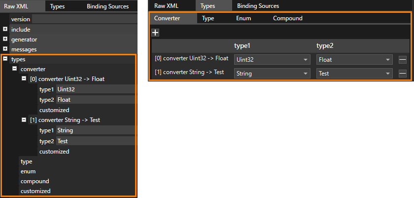

##### <a class="anchor" id="bkmrk--26"></a>XCDDL fundamentals
XCDDL data definition contains compound data type and binding source definitions. Each distinct data entity in the binding source definition is called a *data item*. Data items can be of any C / C++ type as long as this type obeys certain criteria:
<div class="contents" id="bkmrk-the-type-must-define"><div class="contents"><div class="textblock">- the type must define a default constructor
- the type must be copyable (copy c-tor and assignment operators with public access)
- data binding has to perform certain type inspection on the data item types. Therefore the type shall not have protected or private inheritance for a base class
</div></div></div>The following XCDDL snippet defines a RadioStationData type based on a very simplified radio station model.

Processing of [Courier::UpdateModelMsg](http://dev.doc.cgistudio.at/APILINK/class_courier_1_1_update_model_msg.html "Update model message is responsible to carry requests to modify or update data back from view / contr...") takes place in OnUpdateModelMsg.
void SampleAppModelComponent::OnUpdateModelMsg(const UpdateModelMsg *msg)
    using namespace Generated;
    // controller / view request changes in the model data. An UpdateModelMsg
    // may contain multiple change requests for multiple binding sources.
    // the ChangeTracker helps to keep track of the changes and takes over the
    // house keeping tasks like list fragment update, sending of DataItemMsg
    // with modified data, and list event notifications.
    ChangeTracker changeTracker(this,
                                &SampleAppModelComponent::UpdateListFragment,
                                &SampleAppModelComponent::SendBindingSourceUpdate);
    bool ok = true;
    // for every request in the UpdateModelMsg
    for (UInt32 i = 0; ok && i < msg->RequestCount(); ++i) {
        // get request from UpdateModelMsg
        Request request(msg->GetRequest(i));
            case ItemKey::SettingsMenuItem:
                if (OnSettingsMenuListRequest(request)) {
                    ok = changeTracker.RegisterChange(i, request);
                break;
            case ItemKey::TestValuesItem:
                if (OnTestValuesRequest(request)) {
                break;
            case ItemKey::RadioItem:
                break;
            default:
                // unknown binding source
                COURIER_DEBUG_FAIL();
                ok = false;
                break;
        if (!ok) {
            COURIER_LOG_ERROR("update request failed");
    // trigger send of DataItemMsg and ListEvent notifications for the requested
    // changes. changeTracker keeps track which binding source data to update and
    // which list events to send.
    if (!changeTracker.SendChanges(msg)) {
        COURIER_LOG_ERROR("failed to update data");

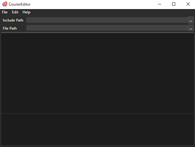

#### Starting Courier Editor
From the Scene Composer menu bar, select \[ File &gt; Define application specifications\], open the "Courier Editor Parameters" dialog, and select \[ Edit... \] to launch CourierEditor.
<div drawio-diagram="5957"><img src="https://doc316en.candera.eu/uploads/images/drawio/2024-06/drawing-7-1717648140.png" alt=""/></div>
<div drawio-diagram="5958"><img src="https://doc316en.candera.eu/uploads/images/drawio/2024-06/drawing-7-1717648178.png" alt=""/></div>
*<span style="text-decoration: underline;">**Courier Editor main window**</span>*

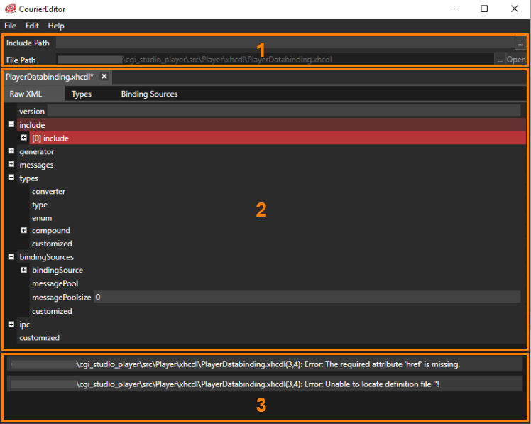

Details of the UI items on CourierEditor main window. The numbers in the diagram match the numbers in the explanations for each item below.
<div drawio-diagram="6964"><img src="https://doc316en.candera.eu/uploads/images/drawio/2024-10/drawing-7-1728614240.png" alt=""/></div>
<table border="1" id="bkmrk-ui%E9%A0%85%E7%9B%AE-%E8%AA%AC%E6%98%8E-1.-%E3%83%91%E3%82%B9-includ" style="border-collapse: collapse; width: 100%; height: 372.938px;"><colgroup><col style="width: 22.1261%;"></col><col style="width: 77.8739%;"></col></colgroup><tbody><tr style="height: 20.7969px;"><td class="align-center" style="background-color: rgb(230, 126, 35); height: 20.7969px;">**<span style="color: rgb(255, 255, 255);">UI item</span>**
</td><td class="align-center" style="background-color: rgb(230, 126, 35); height: 20.7969px;">**<span style="color: rgb(255, 255, 255);">Description</span>**</td></tr><tr style="height: 29.7969px;"><td colspan="2" style="background-color: rgb(251, 238, 184); height: 29.7969px;">**1. Data binding source path information**
</td></tr><tr style="height: 29.7969px;"><td style="height: 29.7969px;">Include Path</td><td style="height: 29.7969px;">Set the save destination of the referenced Data binding source.</td></tr><tr style="height: 29.7969px;"><td style="height: 29.7969px;">File path</td><td style="height: 29.7969px;">Set the save destination of the Data binding source.</td></tr><tr style="height: 52.1875px;"><td colspan="2" style="height: 52.1875px; background-color: rgb(251, 238, 184);">**2. Data binding item editing area**
The top row of tabs is for selecting the data binding source. (When setting Include path)
</td></tr><tr style="height: 57.7812px;"><td style="height: 57.7812px;">Raw XML tab</td><td style="height: 57.7812px;">Information on all items included in the Data binding source is displayed.
You can add/edit/delete items.
</td></tr><tr style="height: 46.5938px;"><td style="height: 46.5938px;">Types tab</td><td style="height: 46.5938px;">Only items included in "types" in Raw XML are displayed in list format.
</td></tr><tr style="height: 46.5938px;"><td style="height: 46.5938px;">Binding Sources tab</td><td style="height: 46.5938px;">Only items included in "bindingSources" in Raw XML are displayed in list format.
</td></tr><tr style="height: 29.7969px;"><td colspan="2" style="height: 29.7969px; background-color: rgb(251, 238, 184);">**3. Verification result view**
</td></tr><tr style="height: 29.7969px;"><td style="height: 29.7969px;">ー</td><td style="height: 29.7969px;">The data binding source validation results are displayed.</td></tr></tbody></table>
#### Create new definition

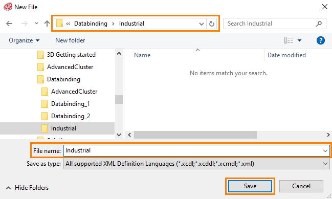

In the "New File" dialog, set the destination and name for the new data binding source, then click \[ Save \].

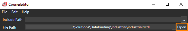

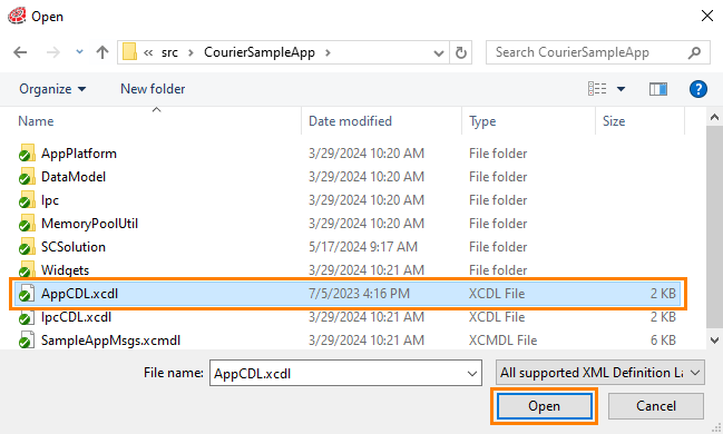

#### Open existing definition
Open an existing Data binding source from \[ File &gt; Open \] in CourierEditor menu bar.
In the Open dialog, select an existing data binding source, then click \[ Open \]..
<div drawio-diagram="5977"><img src="https://doc316en.candera.eu/uploads/images/drawio/2024-06/drawing-7-1717653208.png" alt=""/></div>
In addition to the steps above, you can also open an existing data binding source from the CourierEditor main window. Click the \[...\] button at the right end of File Path to set the path required to open an existing data binding source. The \[Open\] button will appear at the right end of File Path, so click it.
<div drawio-diagram="6970"><img src="https://doc316en.candera.eu/uploads/images/drawio/2024-10/drawing-7-1728614713.png" alt=""/></div>

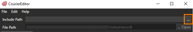

You can set an Include Path for a Data binding source. Include path allows you to pre-include the contents of a specific Data binding source in the Data binding source you are editing by setting the path of the specific Data binding source. For example, by setting a Data binding source that is used for general purposes to a Include Path, there are advantages such as eliminating the need to create a similar Data binding source for each solution.
##### How to set Include Path
To set the Include Path, click the \[ ... \] button at the right end of the Include Path in the CourierEditor dialog to open the "Include path" dialog.
<div drawio-diagram="6966"><img src="https://doc316en.candera.eu/uploads/images/drawio/2024-10/drawing-7-1728614326.png" alt=""/></div>

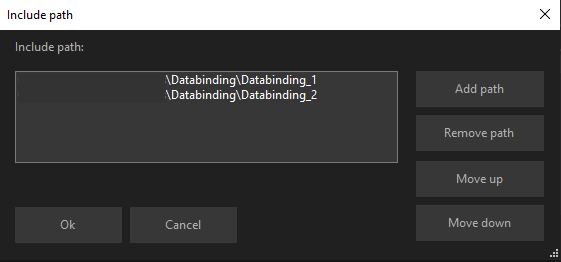

The details of the Include path dialog are as follows. Use \[ Add path \] to set the destination for any Data binding source.
<div drawio-diagram="6967"><img src="https://doc316en.candera.eu/uploads/images/drawio/2024-10/drawing-7-1728614354.png" alt=""/></div>
<table border="1" id="bkmrk-ui%E9%A0%85%E7%9B%AE-%E8%AA%AC%E6%98%8E-add-path-%E3%83%87%E3%83%BC%E3%82%BF" style="border-collapse: collapse; width: 100.053%; height: 159.578px;"><colgroup><col style="width: 15.5692%;"></col><col style="width: 84.4839%;"></col></colgroup><tbody><tr style="height: 29.7969px;"><td class="align-center" style="background-color: rgb(230, 126, 35); height: 29.7969px;"><span style="color: rgb(255, 255, 255);">**UI item**</span></td><td class="align-center" style="background-color: rgb(230, 126, 35); height: 29.7969px;"><span style="color: rgb(255, 255, 255);">**Description**</span></td></tr><tr style="height: 29.7969px;"><td style="height: 29.7969px;">Add path</td><td style="height: 29.7969px;">Sets the path for a specific Data binding source.</td></tr><tr style="height: 29.7969px;"><td style="height: 29.7969px;">Remove path</td><td style="height: 29.7969px;">Removes the path selected in the Include path dialog.</td></tr><tr style="height: 29.7969px;"><td style="height: 29.7969px;">Move up</td><td style="height: 29.7969px;">Moves the display order of the paths selected in the Include path dialog in ascending order.</td></tr><tr style="height: 10.5938px;"><td style="height: 10.5938px;">Move down</td><td style="height: 10.5938px;">Moves the display order of paths set in the Include path dialog in descending order.</td></tr><tr style="height: 29.7969px;"><td style="height: 29.7969px;">OK</td><td style="height: 29.7969px;">Finish setting Include path and proceed to the next step.</td></tr></tbody></table>

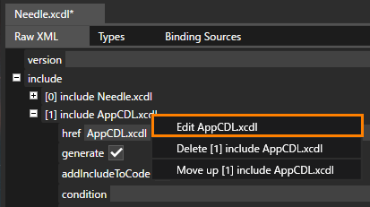

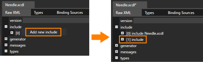

After setting the Include Path in the Include path dialog, perform the following operations in the editing area of the Data binding item.
1. Add an include element by selecting \[ Add new include \] from the context menu of include in the Raw XML tab.
    <div drawio-diagram="5801"><img src="https://doc316en.candera.eu/uploads/images/drawio/2024-05/drawing-7-1716523486.png" alt=""/></div>
2. Enter the file name of specific Data binding source in \[ href \] of the added include element.
    <div drawio-diagram="5802"><img src="https://doc316en.candera.eu/uploads/images/drawio/2024-05/drawing-7-1716523515.png" alt=""/></div>
3. From the context menu of the added include element, choose \[ Edit (filename of specific Data binding source) \].
    <div drawio-diagram="5803"><img src="https://doc316en.candera.eu/uploads/images/drawio/2024-05/drawing-7-1716523543.png" alt=""/></div>
4. The "(specific Data binding source name).xcdl" tab is displayed at the top of the Data binding item editing area.
    <div drawio-diagram="6440"><img src="https://doc316en.candera.eu/uploads/images/drawio/2024-07/drawing-7-1721107898.png" alt=""/></div>
By performing the above operations, specific Data binding source can be included in the Data binding source being edited.

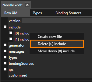

##### Deleting the item
Select \[ Delete (item name you want to delete) \] from the context menu of the item you want to delete.
<div drawio-diagram="5964"><img src="https://doc316en.candera.eu/uploads/images/drawio/2024-06/drawing-7-1717648759.png" alt=""/></div>
##### Types / Binding Sources tabs
The Types and Binding Sources tabs are duplicates of the Raw XML tab's types and bindingSources. By using the Types tab and Binding Sources tab, you can edit the types and bindingSources items in the Raw XML tab, and display them in a list. Edits in the Raw XML tab and the Types/Binding Sources tab are synchronized with each other.
<div drawio-diagram="5806"><img src="https://doc316en.candera.eu/uploads/images/drawio/2024-05/drawing-7-1716526149.png" alt=""/></div>
*<span style="text-decoration: underline;">**Raw XML tab and Type tab**</span>*
<div drawio-diagram="5807"><img src="https://doc316en.candera.eu/uploads/images/drawio/2024-05/drawing-7-1716526190.png" alt=""/></div>
<span style="text-decoration: underline;">***Raw XML tab and Binding Sources tab***</span>

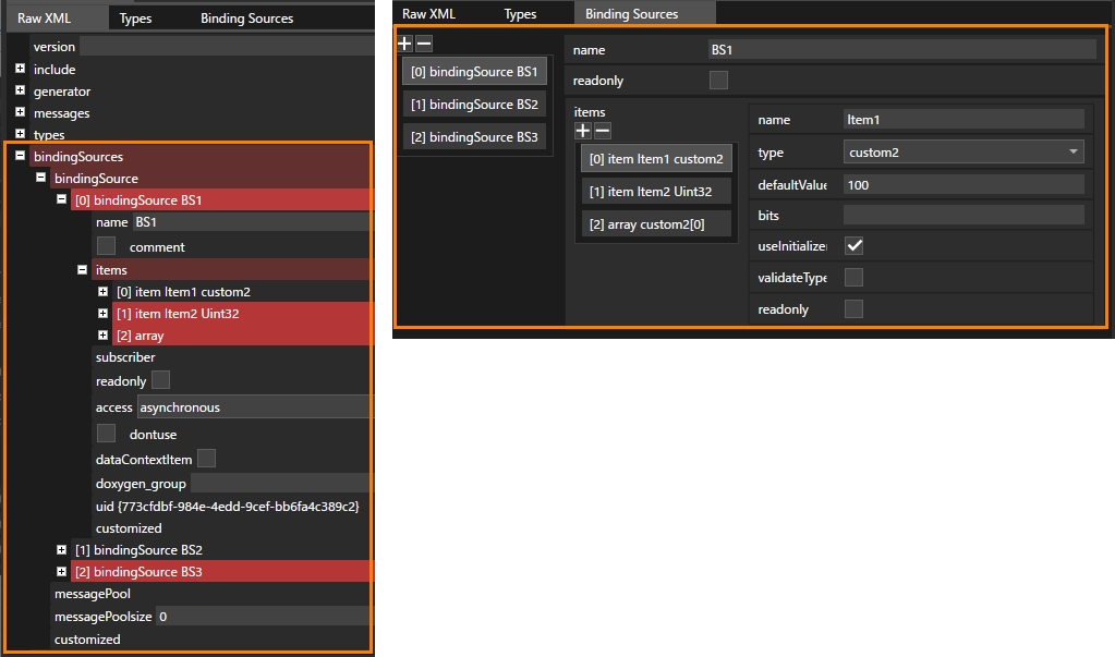

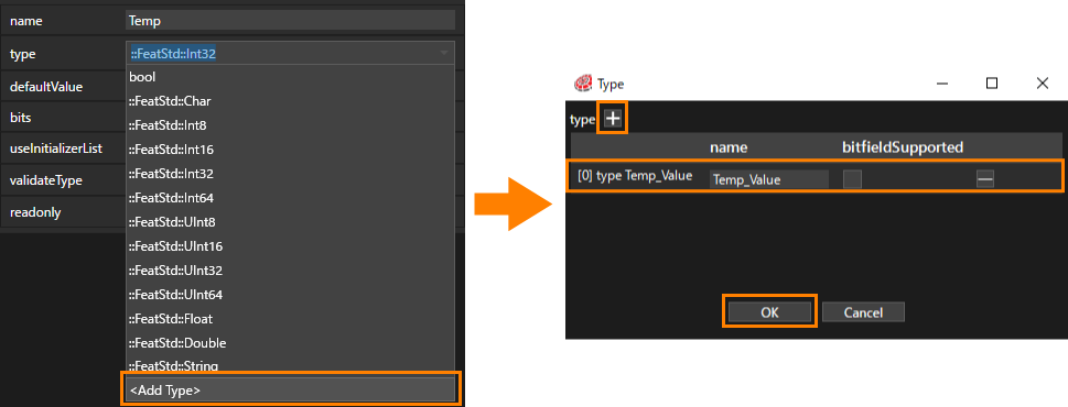

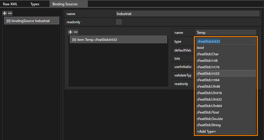

##### Defining the data type of a data binding item
In the Binding Sources tab, you can define the data type of a data binding item. You can select a pre-defined data type from the item &gt; type pull-down menu.
<div drawio-diagram="6000"><img src="https://doc316en.candera.eu/uploads/images/drawio/2024-06/drawing-7-1717746646.png" alt=""/></div>

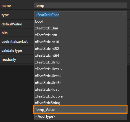

You can define a custom data type by selecting &lt;Add Type&gt; from the type pull-down menu. When you select &lt;Add Type&gt;, the "Type" dialog opens, so click the \[ + \] icon in the upper left. A new data type will be added, so enter the data type information and click \[ OK \].
<div drawio-diagram="6001"><img src="https://doc316en.candera.eu/uploads/images/drawio/2024-06/drawing-7-1717746676.png" alt=""/></div>
The added custom data type will be selectable from the pull-down menu of type.
<div drawio-diagram="6002"><img src="https://doc316en.candera.eu/uploads/images/drawio/2024-06/drawing-7-1717746708.png" alt=""/></div>

##### Specify optional artifacts like the message distribution
- Check the checkbox to the left of each artifact to set the value.
- Note:
    - If not specified the inherited distribution is used
    - The broadcast value is edited by the checkbox on the right side
    - Uid will be automatically created by the editor
<div drawio-diagram="5678"><img src="https://doc316en.candera.eu/uploads/images/drawio/2024-04/drawing-7-1714457821.png" alt=""/></div>

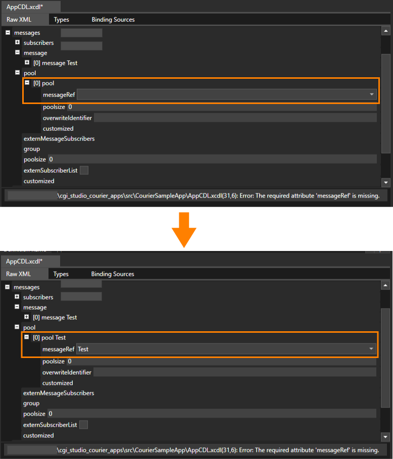

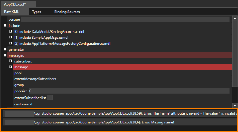

##### Choose references from the dropdown list e. g.
- The data binding source contains a message called "Test".
- In that case, a validation error will occur if the pool's messageRef is not set.
- From the pool's messageRef pull-down menu, select the message "Test".
- messageRef will be set to the uid of the message "Test".
<div drawio-diagram="6968"><img src="https://doc316en.candera.eu/uploads/images/drawio/2024-10/drawing-7-1728614448.png" alt=""/></div>
#### Validation
Validation can be performed in two ways.
- Execute \[ Edit &gt; Validate \] from the menu bar.
- Using the shortcut "Alt+V"
Validation output is shown on the lower part.

2. In the Scene Composer menu bar click \[ File &gt; Define application specification \] to open the "Courier Editor Parameters" dialog.
    - "Courier Editor Parameters" dialog will be opened.
    <div drawio-diagram="7911"><img src="https://doc316en.candera.eu/uploads/images/drawio/2025-02/drawing-5-1738927658.png" alt=""/></div>
3. In the "Courier Editor Parameters" select \[ Edit... \] to start CourierEditor.
    - CourierEditor window will be opened.
    <div drawio-diagram="7910"><img src="https://doc316en.candera.eu/uploads/images/drawio/2025-02/drawing-5-1738927644.png" alt=""/></div>
4. In CourierEditor menu bar, click \[ File &gt; New \].
    - The "New File" dialog box will be opened.
    <div drawio-diagram="7909"><img src="https://doc316en.candera.eu/uploads/images/drawio/2025-02/drawing-5-1738927628.png" alt=""/></div>
5. Set the destination folder and filename for the new data binding source and click \[ Save \].
    - The data binding source file "Industrial.xcdl" will be saved to the specified location.
    - The data binding source file is now ready to be configured with data binding items.

6. Add Data binding items (data name/type) to the created Data binding source. To do so, switch to the Binding Sources tab and click the \[ + \] button on the top left to add a binding source.
    - "\[0\] bindingSource" is added
    <div drawio-diagram="7914"><img src="https://doc316en.candera.eu/uploads/images/drawio/2025-02/drawing-5-1738928212.png" alt=""/></div>
7. Click on "\[0\] bindingSource" to view its details on the right side and set the name to "Industrial".
    - The name of "\[0\] bindingSource" will be set to "Industrial"
    <div drawio-diagram="7917"><img src="https://doc316en.candera.eu/uploads/images/drawio/2025-02/drawing-5-1738928531.png" alt=""/></div>
8. Click the \[ + \] button next to "items" and click \[ Add new item \] in the context menu.
    - "\[0\] item" is added.
    <div drawio-diagram="7918"><img src="https://doc316en.candera.eu/uploads/images/drawio/2025-02/drawing-5-1738928720.png" alt=""/></div>
9. Select data binding item "\[0\] item" view its details on the right side and configure the following name and type:
    name = Temp
    type = ::FeatStd::Int32
    - Data binding item will be configured accordingly.
    <div drawio-diagram="7920"><img src="https://doc316en.candera.eu/uploads/images/drawio/2025-02/drawing-5-1738929282.png" alt=""/></div>

Beside the Messaging and Data Binding capabilities [Courier](http://dev.doc.cgistudio.at/APILINK/namespace_courier.html) can also be used for Visualization purposes.
#### **View and ViewController Instantiation**
##### <a class="anchor" id="bkmrk--24"></a>Description
For instantiation of View and ViewController objects please refer to the following chapters.
##### **View Factory**
There are several methods how View objects might be instantiated. This is always done by a ViewFactory, either by the original [Courier::ViewFactory](http://dev.doc.cgistudio.at/APILINK/class_courier_1_1_view_factory.html) or by a customized ViewFactory using overwritten methods for special purposes.
##### <a class="anchor" id="bkmrk--26"></a>Customized View Factory
If there is the special need to instantiate certain [Courier::View](http://dev.doc.cgistudio.at/APILINK/class_courier_1_1_view.html) objects manually this can be done by overwriting the virtual method [Courier::ViewFactory::Create](http://dev.doc.cgistudio.at/APILINK/class_courier_1_1_view_factory.html#ad421b5ee9235b39354662940f3e2082a).

##### <a class="anchor" id="bkmrk--33"></a>View Tree
As described earlier [Courier::ViewHandler](http://dev.doc.cgistudio.at/APILINK/class_courier_1_1_view_handler.html) maintains a view tree, consisting of [Courier::ViewContainer](http://dev.doc.cgistudio.at/APILINK/class_courier_1_1_view_container.html), [Courier::ViewScene2D](http://dev.doc.cgistudio.at/APILINK/class_courier_1_1_view_scene2_d.html) &amp; [Courier::ViewScene3D](http://dev.doc.cgistudio.at/APILINK/class_courier_1_1_view_scene3_d.html) objects. For explanation of the tree structure please refer to [Courier::ViewHandler](http://dev.doc.cgistudio.at/APILINK/class_courier_1_1_view_handler.html) documentation.
As described earlier two Components are responsible for triggering the following tasks:
<div class="contents" id="bkmrk-courier%3A%3Aviewcompone"><div class="contents"><div class="textblock">- [Courier::ViewComponent](http://dev.doc.cgistudio.at/APILINK/class_courier_1_1_view_component.html):
    - for Message distribution through view tree, down to the views, view controllers and widgets.
    - for sending an application specific message directly to a specified view (refer to <span style="color: rgb(230, 126, 35);">[Sending Messages directly to Views or Widgets](https://doc316en.candera.eu/link/575#bkmrk-sending-messages-dir)</span> )
    - for maintaining the view tree and loading of scenes (triggered by the messages explained in <span style="color: rgb(230, 126, 35);">[Built-in Messages](#bkmrk-built-in-messages)</span> )
- [Courier::RenderComponent](http://dev.doc.cgistudio.at/APILINK/group___c_o_u_r_i_e_r___f_o_u_n_d_a_t_i_o_n.html#ga111beafd1fd94fe52d99eda8c752bcbf "RenderComponent renders both 2D and 3D Views.") (s):
    - for calling the Update methods of the widgets.
    - for rendering the previously invalidated cameras of the invalidated views (scenes).
    - for swapping the buffer of the render targets of the rendered cameras.
</div></div></div>As both components might be executed in different thread contexts they have to be synchronized because they are using the same view tree and its resources. If the ViewComponent has obtained the view tree the RenderComponent(s) will not render and vice versa. Using a single thread will cause sequential processing of the components.

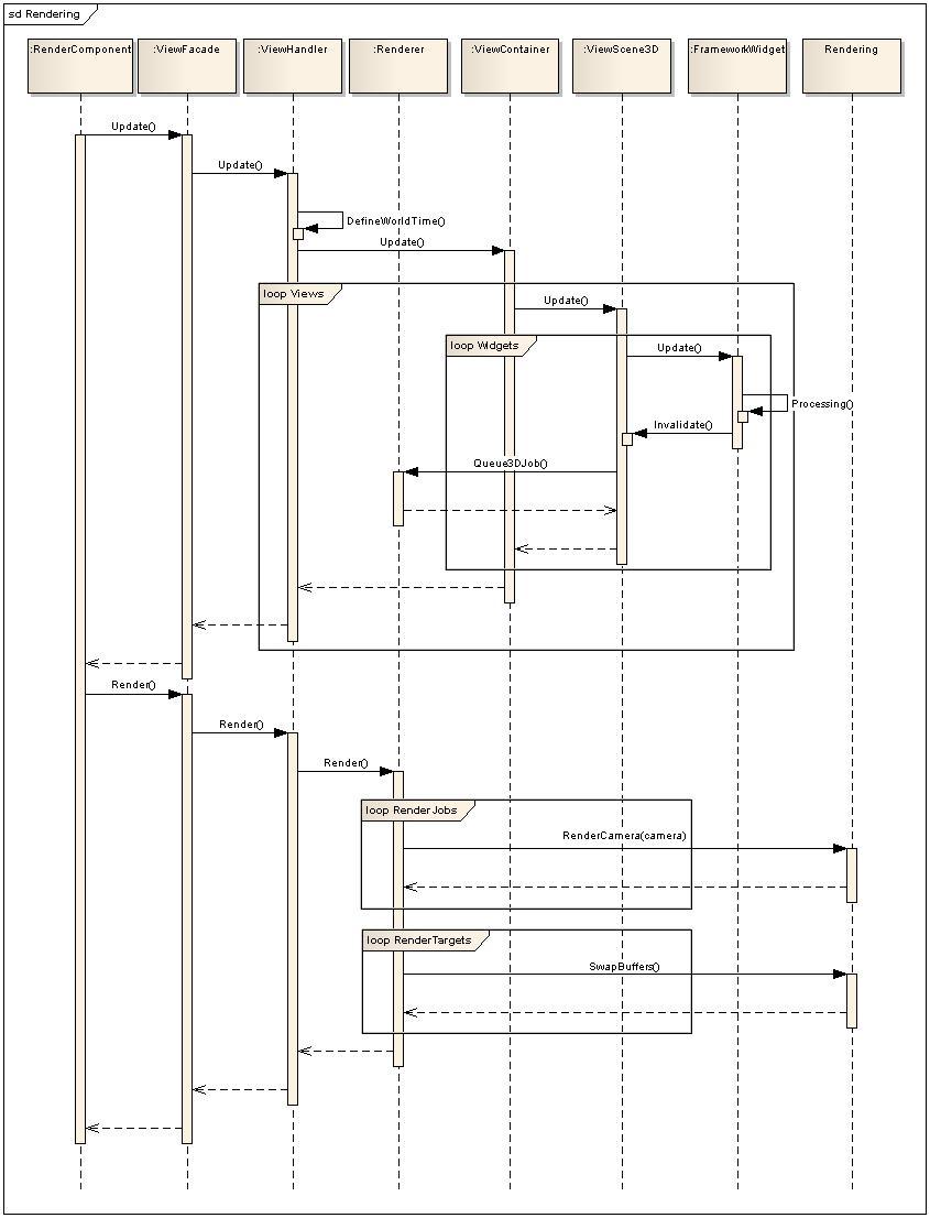

##### <a class="anchor" id="bkmrk--34"></a>Rendering
The invalidation order (invalidating a view might be caused by processing a message or by an update call on the widgets) defines which camera objects and therefore [Candera::Renderer2D::RenderCamera](http://dev.doc.cgistudio.at/APILINK/class_candera_1_1_renderer2_d.html#a44c76b6ec44f705ed78d71ca4f05b66b) and [Candera::Renderer::RenderCamera](http://dev.doc.cgistudio.at/APILINK/class_candera_1_1_renderer.html#a10dbe66b15c60f44cce3aaccd38d2ee5) methods are called by the [Courier::Renderer](http://dev.doc.cgistudio.at/APILINK/class_courier_1_1_renderer.html) used by the [Courier::RenderComponent](http://dev.doc.cgistudio.at/APILINK/group___c_o_u_r_i_e_r___f_o_u_n_d_a_t_i_o_n.html#ga111beafd1fd94fe52d99eda8c752bcbf "RenderComponent renders both 2D and 3D Views."). Render components are used only for updating &amp; rendering purposes and can be executed in their own thread context. Following combinations are possible (other components are ignored here):
<div class="contents" id="bkmrk-singlethreaded%3A-view"><div class="contents"><div class="textblock">- Singlethreaded:
    - ViewComponent &amp; RenderComponent (renders both 2D and 3D views)
    - ViewComponent &amp; RenderComponent2D (renders only 2D views)
    - ViewComponent &amp; RenderComponent3D (renders only 3D views)
    - ViewComponent &amp; RenderComponent2D &amp; RenderComponent3D (renders first 2D views and then 3D views)
- Multithreaded (T1,T2,T3 are threads):
    - ViewComponent(T1) &amp; RenderComponent(T2) (renders both 2D and 3D views)
    - ViewComponent(T1) &amp; RenderComponent2D(T2) (renders only 2D views)
    - ViewComponent(T1) &amp; RenderComponent3D(T2) (renders only 3D views)
    - ViewComponent(T1) &amp; RenderComponent2D(T2) &amp; RenderComponent3D(T2) (2D &amp; 3D views are rendered in the same thread)
    - ViewComponent(T1) &amp; RenderComponent2D(T1) &amp; RenderComponent3D(T2) (2D views are rendered in the same thread T1 as message handling is done)
    - ViewComponent(T1) &amp; RenderComponent2D(T2) &amp; RenderComponent3D(T1) (3D views are rendered in the same thread T1 as message handling is done)
    - ViewComponent(T1) &amp; RenderComponent2D(T2) &amp; RenderComponent3D(T3) (Rendering of 2D &amp; 3D views and messaging is done in three different threads)
</div></div></div>For more details on rendering refer to the following chapter <span style="color: rgb(230, 126, 35);">[Invalidation](#bkmrk-invalidation)</span> because Invalidation &amp; Rendering is tightly coupled in [Courier](http://dev.doc.cgistudio.at/APILINK/namespace_courier.html).
##### <a class="anchor" id="bkmrk--35"></a>Invalidation
[Courier](http://dev.doc.cgistudio.at/APILINK/namespace_courier.html) introduces an invalidation mechanism by providing [Courier::FrameworkWidget::Invalidate](http://dev.doc.cgistudio.at/APILINK/class_courier_1_1_framework_widget.html#a40c3fcf4c499f73e8e9156bef1f78a79 "Invalidates the parent view.") and [Courier::View::Invalidate](http://dev.doc.cgistudio.at/APILINK/class_courier_1_1_view.html#ab0c2b9e33adfb550d0ad840d082b1955) methods, which shall be called if ViewScenes Candera::Camera(s) shall be rendered. Only enabled and invalidated cameras will be rendered. Cameras can be enabled/disabled by sending the appropriate [Courier::ActivationReqMsg](http://dev.doc.cgistudio.at/APILINK/class_courier_1_1_activation_req_msg.html) or by manually maintaining the state of the cameras via widget implementation.
The invalidation of the cameras causes appending a [Courier::RenderJob](http://dev.doc.cgistudio.at/APILINK/class_courier_1_1_render_job.html) to a [Courier::RenderJobs](http://dev.doc.cgistudio.at/APILINK/class_courier_1_1_render_jobs.html) array inside the [Courier::Renderer](http://dev.doc.cgistudio.at/APILINK/class_courier_1_1_renderer.html). This array is then used for rendering the cameras when [Courier::RenderComponent](http://dev.doc.cgistudio.at/APILINK/group___c_o_u_r_i_e_r___f_o_u_n_d_a_t_i_o_n.html#ga111beafd1fd94fe52d99eda8c752bcbf "RenderComponent renders both 2D and 3D Views.") executes the Render method. If the render counter of a RenderJob reaches 0 then the RenderJob is removed from the array of RenderJobs. If a new RenderJob is appended with an already existing RenderJob for this camera, the older entry will be removed.
2D and 3D RenderJobs are processed in their own arrays. This is necessary because of above threading configuration scenarios.
Every Candera::Rendertarget used by a rendered camera will be swapped once after rendering the cameras.
A more specific method of invalidation is the usage of the methods:
<div class="contents" id="bkmrk-courier%3A%3Aviewscene2d"><div class="contents"><div class="textblock">- [Courier::ViewScene2D::Invalidate](http://dev.doc.cgistudio.at/APILINK/class_courier_1_1_view_scene2_d.html#aa5d29150c17c8b7c3029229f323c20d3)([Candera::Camera2D](http://dev.doc.cgistudio.at/APILINK/class_candera_1_1_camera2_d.html "A camera defines the view to the scene. At least one Camera2D has to be added to a 2D scene graph and...") \* invalidatedCamera, UInt8 renderCounter = cDefaultRenderCounter)
- [Courier::ViewScene3D::Invalidate](http://dev.doc.cgistudio.at/APILINK/class_courier_1_1_view_scene3_d.html#afe6364fea300839ec5c7147212cc8fb2)([Candera::Camera](http://dev.doc.cgistudio.at/APILINK/class_candera_1_1_camera.html "A Camera provides Modelview and Projection matrices. Camera is a Transformable.* The eye point is set...") \* invalidatedCamera, UInt8 renderCounter = cDefaultRenderCounter)
</div></div></div>Those methods allow invalidating the specified cameras (not necessarily all cameras of a view) and might also be used in the widget implementations. The widget has therefore use method [Courier::FrameworkWidget::GetParentView](http://dev.doc.cgistudio.at/APILINK/class_courier_1_1_framework_widget.html#a54ff7d5327313cf9350937c0b2868c0c "Returns the parent view."), cast the returned pointer to ViewScene2D or ViewScene3D and then call the appropriate 2D or 3D Invalidation method.

##### <a class="anchor" id="bkmrk--45"></a>Diagram
To give a better overview about the relationship between the classes have a look at the UML diagram which shows the static class structure of the Visualization part used by [Courier::ViewComponent](http://dev.doc.cgistudio.at/APILINK/class_courier_1_1_view_component.html) and [Courier::RenderComponent](http://dev.doc.cgistudio.at/APILINK/group___c_o_u_r_i_e_r___f_o_u_n_d_a_t_i_o_n.html#ga111beafd1fd94fe52d99eda8c752bcbf "RenderComponent renders both 2D and 3D Views."). Also have a look at the Customer::Classes which are usually implemented by the customer himself.
<div drawio-diagram="2742"><img src="https://doc316en.candera.eu/uploads/images/drawio/2023-02/drawing-4-1677478957.png" alt=""/></div>
<div class="contents" id="bkmrk--18"><div class="textblock"><div class="image">
</div></div></div>#####
**Update &amp; Rendering Sequence Diagram**
##### <a class="anchor" id="bkmrk--47"></a>Call Sequence
To give a better overview about the call relationship between the [Courier::ViewComponent](http://dev.doc.cgistudio.at/APILINK/class_courier_1_1_view_component.html) and [Courier::RenderComponent](http://dev.doc.cgistudio.at/APILINK/group___c_o_u_r_i_e_r___f_o_u_n_d_a_t_i_o_n.html#ga111beafd1fd94fe52d99eda8c752bcbf "RenderComponent renders both 2D and 3D Views.") have a look at the UML diagram. Message processing and distribution (not shown here) is done before Update method is called.
<div drawio-diagram="2743"><img src="https://doc316en.candera.eu/uploads/images/drawio/2023-02/drawing-4-1677478992.png" alt=""/></div>
