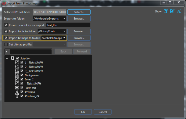

#### Removed limitation of 256 layers for photoshop export/import
Return and parameters type for [Node2D::SetRenderOrderRank](http://dev.doc.cgistudio.at/APILINK/class_candera_1_1_node2_d.html#a44f043fe18c7a3f946983e9dbdea1852), [Node2D::GetRenderOrderRank](http://dev.doc.cgistudio.at/APILINK/class_candera_1_1_node2_d.html#a335694d84284ef00aa0f0f3079c389c3) and [Node2D::GetEffectiveRenderOrderRank](http://dev.doc.cgistudio.at/APILINK/class_candera_1_1_node2_d.html#a6b23bd4be5a0d2c3f1ddac20cc86d830) have been changed from Int8 and Int16 to Int.
<div class="contents" id="bkmrk-"><div class="contents"><div class="textblock">---
