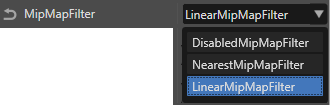

#### <a class="anchor" id="bkmrk--14"></a>Mip Map Filter
This setting is available for all effects using images and controls filtering when the image has a mipmap chain. This Mip Map Filter option is available for all platforms. However, it is applied on OpenGL based 2D implementations only.
#### <a class="anchor" id="bkmrk--15"></a>Values
<div class="contents" id="bkmrk--0"><div class="contents"><div class="textblock"><div class="image"><div drawio-diagram="8637"><img src="https://doc316en.candera.eu/uploads/images/drawio/2025-10/drawing-5-1760710941.png" alt="drawing-5-1760710941.png"/></div>
</div></div></div></div>**DisabledMipMapFilter**
Mipmap filtering is disabled and not applied.
**NearestMipMapFilter**
This method still uses nearest neighbor interpolation, but adds mipmapping — first the nearest mipmap level is chosen according to distance, then the nearest texel center is sampled to get the pixel color. This reduces the aliasing and shimmering significantly, but does not help with blockiness.
**LinearMipMapFilter**
For OpenGL devices LinearMipMapFiltering is a common standard filter mechanism. It is a required standard for all OpenGL versions. It uses nearest-neighbor sampling from individual mipmaps whilst linearly interpolating the two nearest mipmaps relevant to the sample.

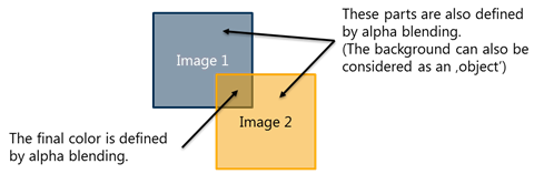

<a class="anchor" id="bkmrk--6"></a>Alpha Blending is the process of combining the pixel data of multiple overlapping objects to a single pixel with a final color and alpha value.
<div class="contents" id="bkmrk-"><div class="contents"><div class="textblock"><div class="image"><div drawio-diagram="2820"><img src="https://doc316en.candera.eu/uploads/images/drawio/2023-02/drawing-4-1677552833.png" alt="drawing-4-1677552833.png"/></div>

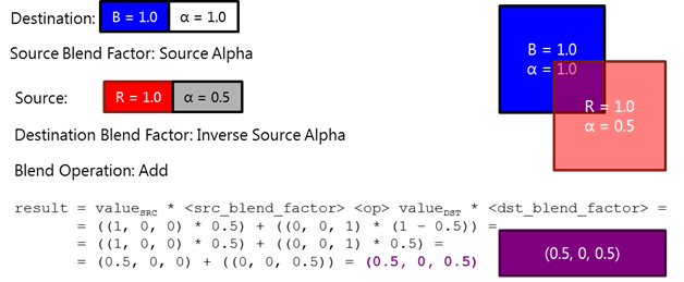

Here is an example on the different blend factors using alpha blending:
<div drawio-diagram="2819"><img src="https://doc316en.candera.eu/uploads/images/drawio/2023-02/drawing-4-1677552811.png" alt="drawing-4-1677552811.png"/></div>
<p class="callout info">Alpha is 1.0 (white) for non-transparent pixels and 0.0 (black) for transparent pixels.</p>

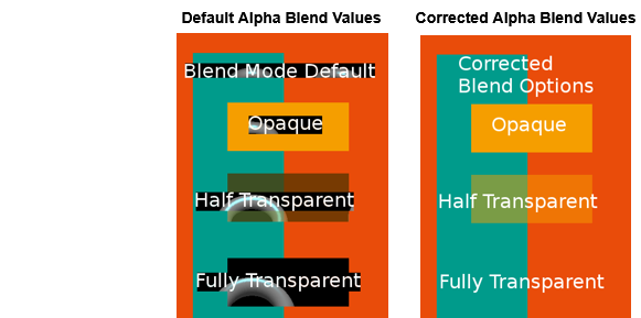

</div></div></div></div>#### <a class="anchor" id="bkmrk--12"></a>Blend Problems

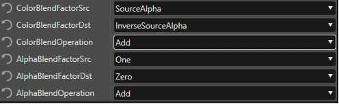

The default values used for blending are set to the following configuration:
<div class="contents" id="bkmrk--3"><div class="contents"><div class="textblock"><div class="image"><div drawio-diagram="2817"><img src="https://doc316en.candera.eu/uploads/images/drawio/2023-02/drawing-4-1677552782.png" alt="drawing-4-1677552782.png"/></div>
</div></div></div></div>The default values ensure maximum performance when no layer blending is needed or no objects with transparency on the same layer are overlapping. The reason is that the Destination Alpha is multiplied with 0 (ignored) and the Source Alpha is used instead. This means the transparency of the last drawn item is used. The default Color Blend Values are fine for all common cases.
In the following example, a partially transparent 2D scene on one layer is rendered over a 3D scene of another layer.
<div class="contents" id="bkmrk--4"><div class="contents"><div class="textblock"><div class="image"><div drawio-diagram="8635"><img src="https://doc316en.candera.eu/uploads/images/drawio/2025-10/drawing-5-1760709992.png" alt="drawing-5-1760709992.png"/></div>
</div></div></div></div><table id="bkmrk-%C2%A0-default-alpha-blen" style="border-collapse:collapse;width:646px;height:342.467px;"><tbody><tr style="height:31.2667px;"><td class="align-center" style="background-color:rgb(35,111,161);width:163.9px;height:31.2667px;"> </td><td class="align-center" style="background-color:rgb(35,111,161);width:235.933px;height:31.2667px;"><span style="color:rgb(255,255,255);">**Default Alpha Blend Values**</span></td><td class="align-center" style="background-color:rgb(35,111,161);width:245.5px;height:31.2667px;"><span style="color:rgb(255,255,255);">**Corrected Alpha Blend Values**</span></td></tr><tr style="height:29.4667px;"><td style="background-color:rgb(53,152,219);width:163.9px;height:29.4667px;">**<span style="color:rgb(255,255,255);">Configuration</span>**</td><td style="width:235.933px;height:29.4667px;">
</td><td style="width:245.5px;height:29.4667px;">
</td></tr><tr style="height:29.4667px;"><td style="background-color:rgb(53,152,219);width:163.9px;height:29.4667px;"><span style="color:rgb(255,255,255);">Alpha Blend Factor Src</span></td><td style="width:235.933px;height:29.4667px;">One</td><td style="width:245.5px;height:29.4667px;">InverseDestAlpha</td></tr><tr style="height:29.4667px;"><td style="background-color:rgb(53,152,219);width:163.9px;height:29.4667px;"><span style="color:rgb(255,255,255);">Alpha Blend Factor Dst</span></td><td style="width:235.933px;height:29.4667px;">Zero</td><td style="width:245.5px;height:29.4667px;">One</td></tr><tr style="height:29.4667px;"><td style="background-color:rgb(53,152,219);width:163.9px;height:29.4667px;"><span style="color:rgb(255,255,255);">Alpha Blend Operation</span></td><td style="width:235.933px;height:29.4667px;">Addd</td><td style="width:245.5px;height:29.4667px;">Add</td></tr><tr style="height:63.0667px;"><td style="background-color:rgb(53,152,219);width:163.9px;height:63.0667px;">**<span style="color:rgb(255,255,255);">Problem caused by</span>**</td><td style="width:235.933px;height:63.0667px;">\- Scene using layers
\- Overlapping objects with transparency
</td><td style="width:245.5px;height:63.0667px;">
</td></tr><tr style="height:130.267px;"><td style="background-color:rgb(53,152,219);width:163.9px;height:130.267px;">**<span style="color:rgb(255,255,255);">Reason</span>**</td><td style="width:235.933px;height:130.267px;">Destination Alpha is multiplied with 0 (ignored), and the source Alpha is used instead. Therefore, the transparency of the last drawn item is used and the background layer with the 3D scene is partially visible.</td><td style="width:245.5px;height:130.267px;">With the corrected Alpha Blend vales, the transparency of the SolidColorNodes is applied as intended and the background layer is not visible.</td></tr></tbody></table>
<p class="callout info">Alpha blending is disabled by default. Blending should not be enabled unless really necessary. Unnecessarily enabling blending will lead to a performance loss. When using images with alpha information, blending can be enabled in the Solutions Options dialog: “File – Solution Options… - Default Render Mode – Enable Blending”</p>

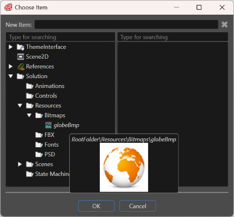

</div></div></div></div>#### <a class="anchor" id="bkmrk--41"></a>Image
This is the place where you configure the image to be displayed by this RenderNode.
<div drawio-diagram="8628"><img src="https://doc316en.candera.eu/uploads/images/drawio/2025-10/drawing-5-1760702469.png" alt="drawing-5-1760702469.png"/></div>
<div class="contents" id="bkmrk-when-clicking-on-the"><div class="contents"><div class="textblock">When clicking on the "magnifying glass"-icon you can choose your desired image from the “Choose Item” dialog, which lists the already imported images.
</div></div></div>A preview of the image is displayed in a tooltip when moving the mouse over the image’s name.
<div drawio-diagram="8627"><img src="https://doc316en.candera.eu/uploads/images/drawio/2025-10/drawing-5-1760699716.png" alt="drawing-5-1760699716.png"/></div>

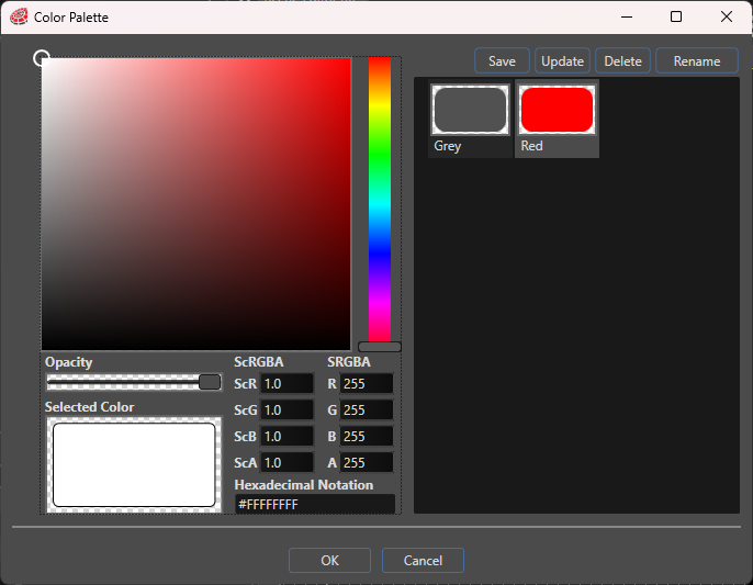

</div></div></div></div>#### <a class="anchor" id="bkmrk--46"></a>Color
The color can be chosen in the “Color Palette” dialog which opens when clicking on the icon on the right.
<div class="contents" id="bkmrk--6"><div class="contents"><div class="textblock"><div class="image"><div drawio-diagram="8629"><img src="https://doc316en.candera.eu/uploads/images/drawio/2025-10/drawing-5-1760702628.png" alt="drawing-5-1760702628.png"/></div>
</div></div></div></div>This dialog also offers the possibility to define and save custom colors you need for your project. This can be achieved by configuring a color and clicking the “Save” button on the top right, which creates a new rectangle in your configured color and allows you to name it.
The default blending color after applying this effect is white.

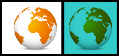

</div></div></div></div>#### <a class="anchor" id="bkmrk--51"></a>Hue
With this property you can alter the color of the image. Increasing the value moves from blue through green, yellow orange, red purple and back to blue. In CGI-Studio the values for hue range from -180 to 180. The value is periodical outside this range.
<table id="bkmrk-hue-value-meaning--1" style="border-collapse:collapse;width:83.0952%;height:119px;"><colgroup><col style="width:16.8079%;"></col><col style="width:83.2053%;"></col></colgroup><tbody><tr style="height:29.8785px;background-color:rgb(35,111,161);"><td class="align-center" style="height:29.8785px;"><span style="color:rgb(236,240,241);">**Hue Value**</span></td><td class="align-center" style="height:29.8785px;"><span style="color:rgb(236,240,241);">**Meaning**</span></td></tr><tr style="height:29.8785px;"><td style="height:29.8785px;">-180</td><td style="height:29.8785px;">Color is inverted (the complementary color of the RGB color system is used)</td></tr><tr style="height:29.8785px;"><td style="height:29.8785px;">0</td><td style="height:29.8785px;">Color is unchanged</td></tr><tr style="height:29.8785px;"><td style="height:29.8785px;">180</td><td style="height:29.8785px;">Color is inverted (the complementary color of the RGB color system is used)</td></tr></tbody></table>
<div class="contents" id="bkmrk-here-is-an-example-o"><div class="contents"><div class="textblock">Here is an example on how the colors are altered in Scene Composer depending on the original color and the applied hue value.
</div><div class="textblock"><div drawio-diagram="2832"><img src="https://doc316en.candera.eu/uploads/images/drawio/2023-02/drawing-4-1677553157.png" alt="drawing-4-1677553157.png"/></div>

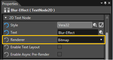

The default renderer of TextNodes is the Bitmap renderer.
<div drawio-diagram="2837"><img src="https://doc316en.candera.eu/uploads/images/drawio/2023-02/drawing-4-1677553260.png" alt="drawing-4-1677553260.png"/></div>
<div class="contents" id="bkmrk--21"><div class="contents"><div class="textblock"><div class="image">
</div></div></div></div>If a TextNode is rendered with the Bitmap renderer, the BlurBitmapBrushBlend effect can also be applied.
<div class="contents" id="bkmrk--22"><div class="contents"><div class="textblock"><div class="image"><div drawio-diagram="2838"><img src="https://doc316en.candera.eu/uploads/images/drawio/2023-02/drawing-4-1677553272.png" alt="drawing-4-1677553272.png"/></div>
</div></div></div></div>#### <a class="anchor" id="bkmrk--64"></a>Filter Size

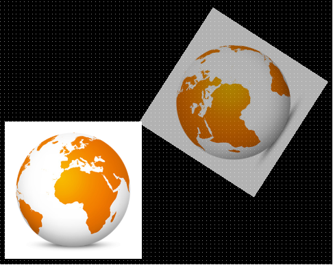

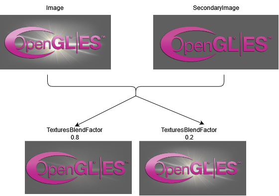

### <a class="anchor" id="bkmrk--65"></a>MirrorBitmapBrushBlend
You can define an image to be rendered with a RenderNode. Additionally, with this effect, the RenderNode is enhanced with a mirror image – a reflection that is mirrored across a defined central line, the mirror axis. Every point has the same distance from this mirror axis and the reflection has the same size as the original image. The effect MirrorBitmapBrushBlend has additional properties to define a mirror axis (Mirror Axis From and Mirror Axis To) and another property to configure the alpha value of the mirror image.
<div drawio-diagram="2839"><img src="https://doc316en.candera.eu/uploads/images/drawio/2023-02/drawing-4-1677553300.png" alt="drawing-4-1677553300.png"/></div>
<div class="contents" id="bkmrk--24"><div class="contents"><div class="textblock"><div class="image">
</div></div></div></div>#### <a class="anchor" id="bkmrk--67"></a>Mirror Axis From, Mirror Axis To
The mirror axis is the central line, where every point has the same distance from. It defines, where exactly this effect mirrors the image to. It is configured by these two points: “Mirror Axis From” and “Mirror Axis To”, each of which has to be configured with an X and a Y coordinate.
<div drawio-diagram="2840"><img src="https://doc316en.candera.eu/uploads/images/drawio/2023-02/drawing-4-1677553313.png" alt="drawing-4-1677553313.png"/></div>
<div class="contents" id="bkmrk--26"><div class="contents"><div class="textblock"><div class="image">
</div></div></div></div>#### <a class="anchor" id="bkmrk--69"></a>Alpha
This property defines the opacity of the mirrored image. A value of 1 means the mirror image is opaque, a value of 0 means the mirror image is totally transparent.

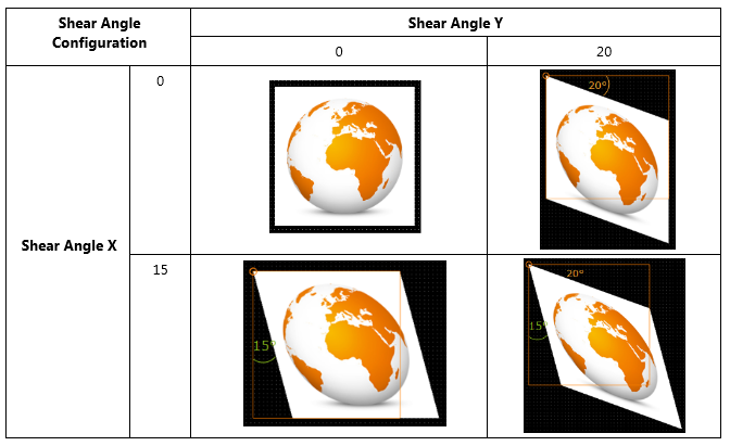

</div></div></div></div>#### <a class="anchor" id="bkmrk--73"></a>Shear Angle X, Shear Angle Y
These two properties define the shearing of the image. Shear Angle X defines the horizontal shearing angle, Shear Angle Y defines the vertical shearing angle.
<div drawio-diagram="2844"><img src="https://doc316en.candera.eu/uploads/images/drawio/2023-02/drawing-4-1677553386.png" alt="drawing-4-1677553386.png"/></div>
<div class="contents" id="bkmrk-%28note-that-the-angle"><div class="contents"><div class="textblock">(Note that the angle is displayed here for explanation reasons and is not displayed in SceneComposer.)
</div></div></div>If a TextNode is rendered with the Bitmap renderer, which is the default, the ShearBitmapBrushBlend effect can also be applied.

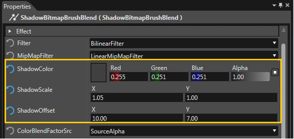

</div></div></div></div>### <a class="anchor" id="bkmrk--76"></a>ShadowBitmapBrushBlend
This effect allows to display a Bitmap on a RenderNode and additionally add a shadow in the background of this Bitmap. For proper configuration, 3 parameters for Shadow Color, Shadow Scale and Shadow Offset can be altered.
<div drawio-diagram="2846"><img src="https://doc316en.candera.eu/uploads/images/drawio/2023-02/drawing-4-1677553425.png" alt="drawing-4-1677553425.png"/></div>
<div class="contents" id="bkmrk--33"><div class="contents"><div class="textblock"><div class="image">
</div></div></div></div>#### <a class="anchor" id="bkmrk--78"></a>Shadow Color
With this parameter the color of the shadow can be configured. The color can be chosen in the “Color Palette” dialog, which opens when clicking on the rectangular color preview. The default Shadow Color is white.
#### <a class="anchor" id="bkmrk--79"></a>Shadow Scale
The property “Shadow Scale” defines the shadow’s size and proportions. With a Shadow Scale of “1;1” the shadow is as big as the displayed Bitmap and is not visible, if the Shadow Offset is set to “0;0”. Setting the X coordinate of the Shadow Scale to 2, makes the shadow twice as wide. When enlarging the Shadow Scale, the center of the shadow remains at the center of the Bitmap.
<div drawio-diagram="2847"><img src="https://doc316en.candera.eu/uploads/images/drawio/2023-02/drawing-4-1677553440.png" alt="drawing-4-1677553440.png"/></div>
<div class="contents" id="bkmrk--35"><div class="contents"><div class="textblock"><div class="image">
</div></div></div></div>#### <a class="anchor" id="bkmrk--81"></a>Shadow Offset
With the Shadow Offset property the horizontal and vertical offset of the shadow’s center to the center of the displayed Bitmap can be configured. The values are given in pixels.
<div drawio-diagram="2848"><img src="https://doc316en.candera.eu/uploads/images/drawio/2023-02/drawing-4-1677553453.png" alt="drawing-4-1677553453.png"/></div>
<div class="contents" id="bkmrk--37"><div class="contents"><div class="textblock"><div class="image">
</div></div></div></div>If a TextNode is rendered with the BitmapRenderer, which is the default, the ShadowBitmapBrushBlend effect can also be applied.

</div></div></div></div>The color can be chosen in the “Color Palette” dialog where you can also define and save the custom colors you need for your project. The default blending color after applying this effect is white.
<div class="contents" id="bkmrk--0"><div class="contents"><div class="textblock"><div class="image"><div drawio-diagram="8631"><img src="https://doc316en.candera.eu/uploads/images/drawio/2025-10/drawing-5-1760705174.png" alt="drawing-5-1760705174.png"/></div>

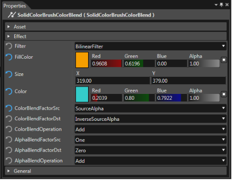

### <a class="anchor" id="bkmrk--12"></a>SolidColorBrushColorBlend
A SolidColorBrushColorBlend effect adds a color effect to the existing SolidColorBrushBlend effect. It multiplies the <span style="color:rgb(230,126,35);">[FillColor](https://doc316en.candera.eu/link/603#bkmrk-fillcolor)</span> with the <span style="color:rgb(230,126,35);">[Color](https://doc316en.candera.eu/link/603#bkmrk-color-0)</span>. This effect can be useful when it comes to reusing ColorEffects out of an effect, to multiply a color with the actual color to blit; especially in cases where the original color should be preserved, but should be changed for certain effects.
<div class="contents" id="bkmrk--1"><div class="contents"><div class="textblock"><div class="image"><div drawio-diagram="2852"><img src="https://doc316en.candera.eu/uploads/images/drawio/2023-02/drawing-4-1677553594.png" alt="drawing-4-1677553594.png"/></div>
</div></div></div></div>#### <a class="anchor" id="bkmrk--14"></a>Filter
For more details please see chapter <span style="color:rgb(230,126,35);">[Filter](https://doc316en.candera.eu/link/600#bkmrk-filter)</span> of the "Basic Effect Properties" page.
#### <a class="anchor" id="bkmrk--15"></a>FillColor
The FillColor is the solid color for this effect.
#### <a class="anchor" id="bkmrk--16"></a>Size
This property defines the horizontal and vertical size of the Node in pixels.
#### <a class="anchor" id="bkmrk--17"></a>Color
The SolidColorBrushColorBlend's Color property defines the constant color for modulating all input color channels (RGBA).
#### <a class="anchor" id="bkmrk--18"></a>Blending
There are several parameters that can be edited to adjust the color blending:
<div class="contents" id="bkmrk-colorblendfactorsrc-"><div class="contents"><div class="textblock"><table><tbody><tr><td>
- ColorBlendFactorSrc
- ColorBlendFactorDst
- ColorBlendOperation
</td><td>
- AlphaBlendFactorSrc
- AlphaBlendFactorDst
- AlphaBlendOperation
</div></div></div>*BlendFactor*

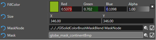

</div></div></div></div>#### <a class="anchor" id="bkmrk--5"></a>Fill Color
<div class="contents" id="bkmrk--0"><div class="contents"><div class="textblock"><div class="image"><div drawio-diagram="2857"><img src="https://doc316en.candera.eu/uploads/images/drawio/2023-02/drawing-4-1677553902.png" alt="drawing-4-1677553902.png"/></div>
</div></div></div></div>#### <a class="anchor" id="bkmrk--7"></a>Size
This property defines the horizontal and vertical size of the SolidColorNode in pixels.

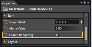

#### <a class="anchor" id="bkmrk--8"></a>Mask Node
The “Mask Node” provides transformation information (that means position, orientation and scaling factor) for the mask image. If no Mask Node is configured, the mask is set to the same position as the displayed image with no rotation and scaling factor 1.
<div class="contents" id="bkmrk--1"><div class="contents"><div class="textblock"><div class="image"><div drawio-diagram="2858"><img src="https://doc316en.candera.eu/uploads/images/drawio/2023-02/drawing-4-1677553926.png" alt="drawing-4-1677553926.png"/></div>
</div></div></div></div>One way to position the mask properly is to create a BitmapNode with the mask image and apply the necessary transformations. With the visible mask image, the correct position, rotation and scaling factor can easily be found. After the desired position is set to this BitmapNode, the property “Enable Rendering” can be unchecked to make this node disappear.
<div class="contents" id="bkmrk--2"><div class="contents"><div class="textblock"><div class="image"><div drawio-diagram="2859"><img src="https://doc316en.candera.eu/uploads/images/drawio/2023-02/drawing-4-1677553949.png" alt="drawing-4-1677553949.png"/></div>
</div></div></div></div>Now, this BitmapNode can be set as Mask Node by choosing it from the “Choose Item” dialog.
#### <a class="anchor" id="bkmrk--11"></a>Mask
An image with alpha information can be configured as mask for this solidly colored rectangle. This way, the mask image can add alpha information to a plain rectangle without alpha information. The color information of the mask image is not taken into account. Also, blend options are not applied between the displayed solid rectangle and the mask image.

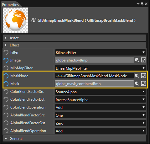

### <a class="anchor" id="bkmrk--7"></a>GlBitmapBrushMaskBlend
This effect allows to add a mask (i.e. to add additional alpha information) to an image by defining a mask image. The position, orientation and scaling of this mask image is defined by a Mask Node.
<div drawio-diagram="2860"><img src="https://doc316en.candera.eu/uploads/images/drawio/2023-02/drawing-4-1677559277.png" alt="drawing-4-1677559277.png"/></div>
#### <a class="anchor" id="bkmrk--9"></a>Image
Here you can define the image that should be displayed. The image can be selected from the list of imported images in the “Choose Item” dialog. The mask itself is configured with the two additional properties “Mask Node” and “Mask”.
<div drawio-diagram="2862"><img src="https://doc316en.candera.eu/uploads/images/drawio/2023-02/drawing-4-1677559323.png" alt="drawing-4-1677559323.png"/></div>
</div></div></div></div>#### <a class="anchor" id="bkmrk--11"></a>Mask
An image with alpha information can be configured as mask for another image. This way, the mask image can add alpha information to an image without alpha information. The color information of the mask image is not taken into account. Also, blend options are not applied between the displayed bitmap and the mask image.
<div drawio-diagram="2863"><img src="https://doc316en.candera.eu/uploads/images/drawio/2023-02/drawing-4-1677559341.png" alt="drawing-4-1677559341.png"/></div>
</div></div></div></div>#### <a class="anchor" id="bkmrk--13"></a>Mask Node
The “Mask Node” provides transformation information (that means position, orientation and scaling factor) for the mask image. If no Mask Node is configured, the mask is set to the same position as the displayed image with no rotation and scaling factor 1. The Mask Node can be selected in the “Choose Item” dialog that opens after clicking the icon to the right of the property’s value.

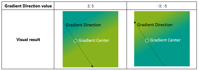

</div></div></div></div>#### <a class="anchor" id="bkmrk--16"></a>Gradient Center
This 2D coordinate value defines the center of the gradient effect. This is the position where both colors are half opaque. The gradient center coordinate is relative to a bounding box: 0 indicates 0% of the bounding box and 1 indicates 100% of the bounding box.

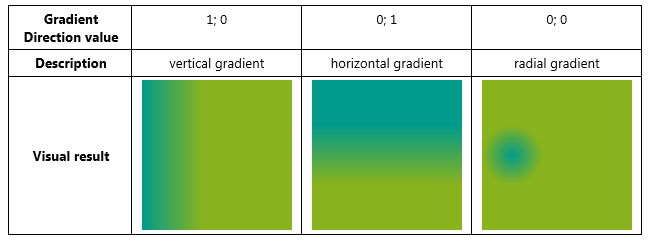

#### <a class="anchor" id="bkmrk--17"></a>Gradient Direction
This 2D vector value defines the direction of the gradient effect. The colors of the gradient can be switched by changing the direction of this vector.
<div drawio-diagram="2867"><img src="https://doc316en.candera.eu/uploads/images/drawio/2023-02/drawing-4-1677559466.png" alt="drawing-4-1677559466.png"/></div>
</div></div></div></div>There are three special gradient directions that need to be addressed:
<div drawio-diagram="2868"><img src="https://doc316en.candera.eu/uploads/images/drawio/2023-02/drawing-4-1677559476.png" alt="drawing-4-1677559476.png"/></div>
</div></div></div></div>#### <a class="anchor" id="bkmrk--20"></a>Gradient Magnitude

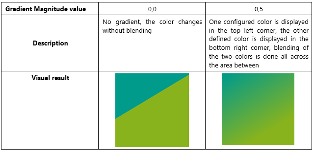

#### <a class="anchor" id="bkmrk--29"></a>Gradient Magnitude
Defines the magnitude of the gradient effect. The magnitude is the distance from the center point to the closest point where the radial color is fully opaque and the center color is fully transparent.
<div class="contents" id="bkmrk--10"><div class="contents"><div class="textblock"><div class="image"><div drawio-diagram="2872"><img src="https://doc316en.candera.eu/uploads/images/drawio/2023-02/drawing-4-1677559532.png" alt="drawing-4-1677559532.png"/></div>
</div></div></div></div>There are two special values for the Gradient Magnitude:

</div></div></div></div>#### <a class="anchor" id="bkmrk--13"></a>MipMapFilter
MipMapping is used to save filtering work during texture minification by prefiltering the texture and storing it in smaller sizes. The applied MipMapFilter algorithm can be selected here. You can choose from no filtering at all, nearest neighbor filtering or linear filtering.

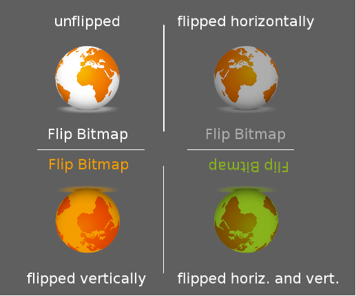

</div></div></div></div>#### <a class="anchor" id="bkmrk--17"></a>Example
Here is an example on horizontal and vertical flipping using the GlFlipBitmapBrushBlend effect.
<div class="contents" id="bkmrk--5"><div class="contents"><div class="textblock"><div class="image"><div drawio-diagram="2877"><img src="https://doc316en.candera.eu/uploads/images/drawio/2023-02/drawing-4-1677559688.png" alt="drawing-4-1677559688.png"/></div>

</div></div></div></div>##### <a class="anchor" id="bkmrk--19"></a>More Shadow Properties
<div drawio-diagram="2885"><img src="https://doc316en.candera.eu/uploads/images/drawio/2023-02/drawing-4-1677560042.png" alt="drawing-4-1677560042.png"/></div>
<div class="contents" id="bkmrk-light-angle%3A-angle-o"><div class="contents"><div class="textblock"><table style="width:67.6191%;height:88.4001px;"><tbody><tr style="height:29.4667px;"><td style="width:23.6418%;height:29.4667px;">**Light Angle:** </td><td style="width:76.2985%;height:29.4667px;">Angle of virtual light that creates the shadow effect.</td></tr><tr style="height:29.4667px;"><td style="width:23.6418%;height:29.4667px;">**Distance:** </td><td style="width:76.2985%;height:29.4667px;">Distance in pixels in which the shadow is cast at the given angle.</td></tr><tr style="height:29.4667px;"><td style="width:23.6418%;height:29.4667px;">**Shadow Scale:** </td><td style="width:76.2985%;height:29.4667px;">The size of the shadow in pixels.</td></tr></tbody></table>

##### <a class="anchor" id="bkmrk--26"></a>Blending Options
To configure the color blending, several color blend options are available.
More details regarding color blending properties in CGI Studio can be found at the <span style="color:rgb(230,126,35);">[SolidColorBrushColorBlend effect](https://doc316en.candera.eu/link/603#bkmrk-blending)</span>.
Further information about blending in general are given in chapter <span style="color:rgb(230,126,35);">[Blending](https://doc316en.candera.eu/books/2d-effects/page/blending)</span>.

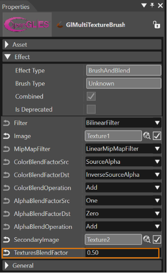

The core functionality inside the `GlMultiTextureBrushBlend::Render` method:
```c++
static_cast<void>(ActivateSecondaryImage(output));
Internal::Context2DOver3DDevicePool& pool = Internal::Context2DOver3DDevicePool::GetInstance();
FeatStd::Internal::Guid guid("8D86313D-47B2-49BD-89C3-DBD24E23A5A1");
Float texturesBlendFactor = m_texturesBlendFactor.Get();
texturesBlendFactor = (texturesBlendFactor < 0.0F) ? 0.0F : texturesBlendFactor;
texturesBlendFactor = (texturesBlendFactor > 1.0F) ? 1.0F : texturesBlendFactor;
Internal::Context2DOver3DDevicePool::CustomUniform customUniforms[1] = {
	{ Internal::Context2DOver3DDeviceProgram::FloatUniform, "u_TexturesBlendFactor", texturesBlendFactor }
pool.SetCustomProgram(s_vertexShader, s_fragmentShader, customUniforms, 1, guid);
m_bitmapBrush.Render(input, inputArea, transform, node, output, outputArea);
if (pool.HasCustomProgram()) {
	pool.ResetCustomProgram();
success = DeactivateSecondaryImage(output) && success;
As seen above, the value from the effect property `m_texturesBlendFactor` is normalized and then provided as uniform `u_TexturesBlendFactor`, which is used by shader code defined with `s_vertexShader` and `s_fragmentShader`.
<p class="callout info">Parameters for the shader are provided as uniforms. For the user, the parameters are exposed as Effect properties!</p>
